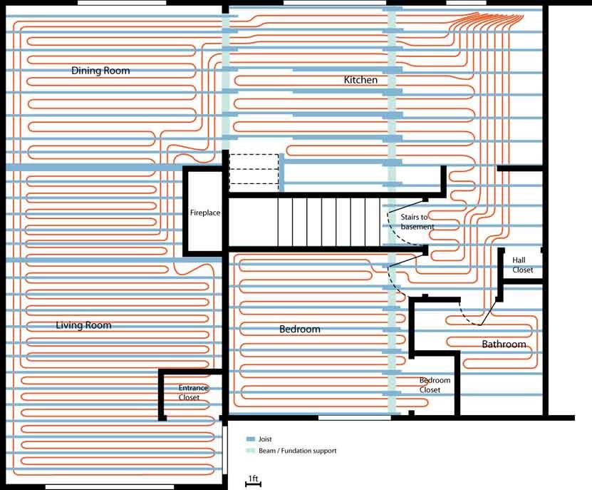

Note : floor plan + floor radiant loop attached ...
Attachment: Floor plan.jpg

first, you don't want any single runs in a joist bay, ever. makes the install way harder. looks like you are skipping your tub area as well and you shouldn't.
hydro air will not operate more efficiently than radiant. but if you need payback to justify radiant, you are barking up the wrong tree. you will likely never pay back the difference in hydro air vs radiant.

the single run in the joist bay are due to the fact that the joist are apart 8'' in these area or less so in that case how should I do.
For the tub you are right I was skipping it -> will not do anymore ... I am also skipping the toilet (which I know I should) as well as the sink area (good/bad ?)
