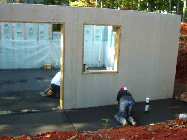

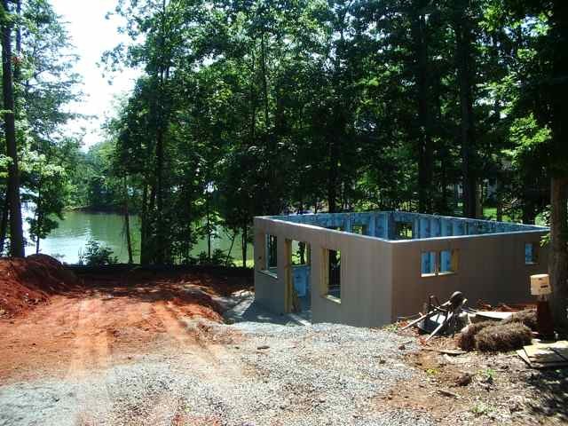

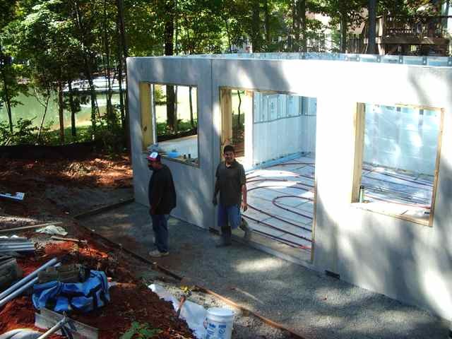

I am building an 1100 ft three floor cottage. The basement is superior walls, the slab is 5.5 to 7 inch slate colored concrete tobeter absorb heat, and will be the finished surface. In the slab is 300 ft of 7/8 pex. We are now abou to order our floor trusses for the second floor and befre i do this I wanted to get some opinions on my best method for the 2nd and 3rd floors. One option would be lightweight concrete. I like this option for sound transmition and the flywheel effect of the thermal mass and lower temps. Sizing up the trusses at this point would not be that bad just need to know what thickness i would need. This would be tiled over. Staple up would be fairly easy with trusses but would require higher temps. Warmboard would be awesome but expensive. This floor area is less than 500 feet for the second floor. Open room, half vaulted ceiling, Half covered with loft. The house is going to be 6 inch sips with lots of southern windows and generous overhangs. All opinions appreciated . Thanks michael

More picts for perspective.
