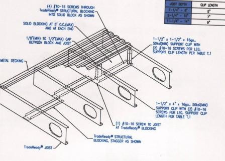

Michael;
Dietrich has a great residential (trimable) joist sytem with metal pan / for concrete topping able to clear span over 30 ft.
They have done free engineering for me in the past
