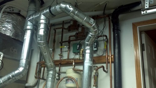

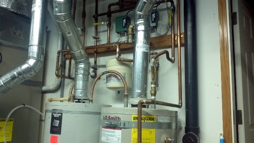

Here are some pictures of my existing system.  The parts are Taco SR 501 relays and 008-BF6 cartridge circulators (bronze) + expansion tank & air eliminator.  When looking at the first picture, there are 6 vertical pipes.  From left to right, they are:
1) Domestic hot water
2) Radiant supply to circulator (garage zone)
3) Cold water in from street
4) Radiant supply to circulator (house addition).  The output from the circulator splits into a copper line and a PEX line.  Any idea why this was done?  Is the addition's hot water being supplied through the circulator ?!?
5) Cold water into water heater (1-way valve installed).  I had to install this because when the pumps were operating we got hot water pushed back into our domestic cold water pipes.
6) Radiant water return to water heater (enters bottom of water heater)
Question: what is salvageable from this system?  Should I consider new relays or can these tie into (signal) the XPB?
