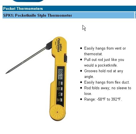

I use these.
They are still kind of hard to push in and if you aren't careful,  the end pulls off when you pull it out.  The first time this happened,  I thought I had ruined it,  but it slides back on fine.
A little duck butter works great also.
Available here

Another option for you.  I found a needle probe tip temp sensor or a reduced tip pocket thermometer on the Cole Palmer web site that might work.  Maybe something like this.  I'm not sure how much you were wanting to spend but i am sure it is competitive with the WEL unit.  That thing is high!  I was considering getting it myself as my GSHP woes continue as well and I am fairly sure it has to do with my ground loop.  I own one of those little cheap temp probes you usually see the hvac repairman has stuck in his van ac vent.  It looked like it was way too large to be forced into the port.  Is it?  Anyway good luck.

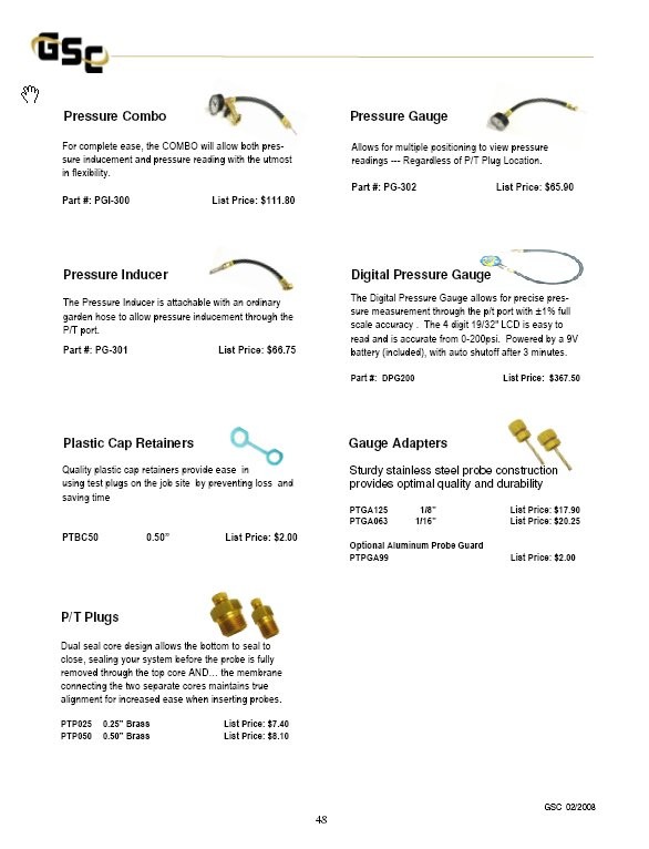

Dean (or anyone) what do you use for pressure? Any digital gauge similar to the temp one above?

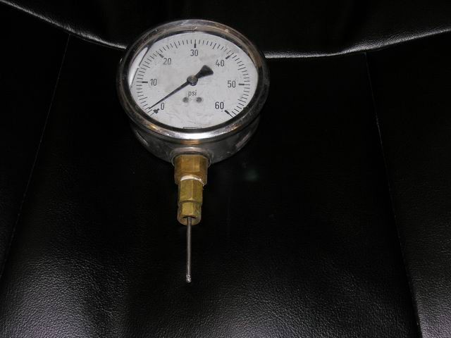

Posted By Brock on 12/28/2008 2:04 PM
Digital gauges are too pricey for  me.
Attachment: Resize of Gauge.jpg

30 Dec 2008 12:05 PM
That appears to be a needle fitting normally used fo athletic ball inflation - probably about as good as it gets for pressure measurement through a Pete port - narrow and with a rounded tip. I just wish there was something as narrow and rounded for temperature.

These come in two diameters.  One is about the same as a ball inflator 1/16", the  other is larger, 1/8".  We prefer the larger for the sturdiness factor.
Attachment: ScreenHunter_42.jpg

Several people have asked about GSC.  It is Geothermal Supply Company .
They are good people with great service.
