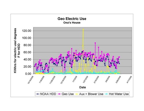

House size - 1950 sq ft
System type/size - WaterFurnace 3 ton (038) with desuperheater & 2 zone
(although zones were not working until February '09
Geographic Location - Upstate NY
Average price/ KWhr - 12cents
KW usage for:
Nov 08
GeoThermal system used 718 KWhrs
Electric coil backup + blower used 61 KWhrs
Heating Degree Days = 765
Dec 08
GeoThermal system used 1185 KWhrs
Electric coil backup + blower used 108 KWhrs
Heating Degree Days = 1133
Jan 09
GeoThermal system used 1678 KWhrs
Electric coil backup + blower used 748 KWhrs!
Heating Degree Days = 1449
Feb 09
GeoThermal system used 1318 KWhrs
Electric coil backup + blower used 73 KWhrs
Heating Degree Days = 1054
As you can see, in January my backup skyrocketed!  This is most likely explained by the long period of freezing weather bringing down my loop temp.  What I can tell from my data so far is that when the HDD's go above 40, my aux heat comes on.  On the day that we had HDD>60, I used almost 200 KWhrs in just that one day.
Regarding costs, I used my previous 4 years oil use and came out with an average rate of oil use per HDD.  Using this rate, and the average weekly price of fuel oil (from NYSERDA webiste) I assumed that I could purchase oil weekly at the cheapest rate (I know that this is not realistic).  Based on that data I would have spent ~ $2,300 on oil in this time period.  My actual electricity cost was $840.  So my savings this winter was ~$1,460.  Well, who knew that oil prices would be almost HALF of what they were the previous year??!  If oil prices had remained the same this would have been a more significant savings.
This is what my usage graph looks like:
Attachment: HDD.jpg
