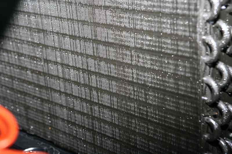

Particularly with the WaterFurnace Envision units, that have an exceptionally large evaporator coil, you'd be surprised how much water stays in the coil after a cooling cycle is finished.  If you're running the blower ECM fan on continuous, then, during non-cooling periods you are simply putting the water right back in to your inside environment.
Below is an image of an Envision 3 ton unit, that I have, that' just like yours, showing the water accumulation.

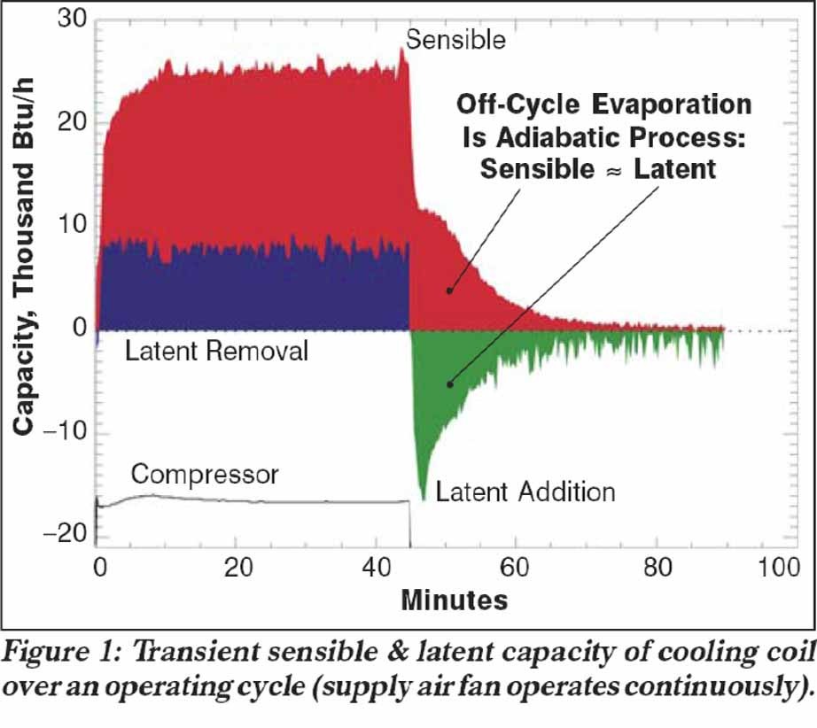

The next image is a chart demonstrating why running the fan on continuous, in cooling mode, in a non-arid climate, is self defeating.

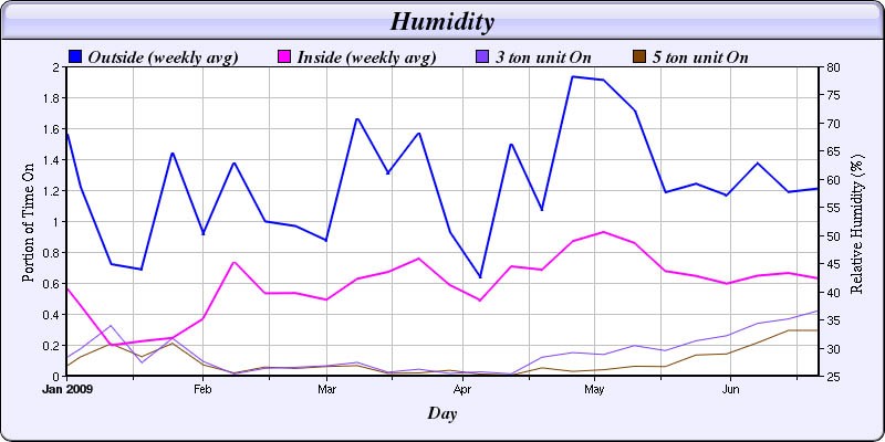

Yes, the more you seal your structure from the outside, the more it will help the inside humidity level.  There is a clear relationship between outside and inside RH levels.  See the last chart below.
This chart shows the inside RH (magenta line) follows the outside RH (blue line) - this is for a Dallas climate.  Each data point is a weekly average.  You can see in the latter half of April and the beginning part of May that outside RH was, on average for week long periods, upwards of 80%.  Not surprisingly, with AC running on average only 15 - 20% of the time (violet and brown lines), this is not enough run time to manage down the inside RH, resulting in inside RH staying around 50%.
Once outside RH settled down to our Summer average near 60%, and once outside temps got hot enough to increase the AC run time to about 35%, inside RH gets managed down nicely at near 40%.
The Envision evap coils have a lot of surface area and thus excel at dehumidification.  Once it gets hot enough for you to get your runtime at 40%+, you should see your indoor RH drop down to a lower range.
