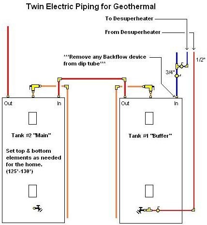

In the thread "It's Hot in Dallas!" page two has a post by me with a drawing for piping up a desuperheater. I don't know why I can't get it to post here...
You will notice, on the cold water "IN" pipe,  there is a ball valve located BELOW the tee for the desuperheater. This makes purging the desuperheater lines quick and easy. Turn off that ball valve and open a hot water faucet. All the water WILL go through the desuperheater, re-inject into the bottom of the buffer tank, move through the main tank and out to the faucet.
On the 1/2" lines for the desuperheater there are two 1/2" ball valves. These are for servicing and flow balancing. If the unit ever needs to be serviced the ball valves can be turn off.
Balancing the flow through the desuperheater is very important. Most manufacturers want an 8~12* delta T through the desuperheater. Too much flow means not enough delta T, not enough flow means too high delta T. The lower ball valve can be closed down, a bit, to lower the flow and set the required delta T. Once done, the handles of both ball valves should be removed and stored inside the unit. This will prevent the flow rate from being changed accidentialy.
Finally, it is VERY IMPORTANT that any type of backflow preventer be removed from the cold "in" nipple and the dip tube. We draw water up through the dip tube, through the desuperheater and back into the bottom of the buffer tank. This insures no seddiments are drawn into the circulator's impeller.

... You will notice, on the cold water "IN" pipe,  there is a ball valve located BELOW the tee for the desuperheater. This makes purging the desuperheater lines quick and easy. Turn off that ball valve and open a hot water faucet. All the water WILL go through the desuperheater, re-inject into the bottom of the buffer tank, move through the main tank and out to the faucet.
Bergy, this is exceptionally helpful.  It makes it easy to purge the DSH lines very easy.  And, it eliminates the need to install a 'Venting Waste Valve' at the highest point of the DSH line.
Unfortunately I didn't have your good advice when I plumbed my DSH.  And thus, I have my 3/4" valve ABOVE the tee for the DSH.  I'll have to fix this.
I've attached below your excellent drawing for the benefit of all others here.
Attachment: Twin Electric Piping for Geothermal Desuperheater.

You first need to make sure your system is plumbed correctly. It helps to make a drawing of some sort. If all the piping is correct, find out if the contractor removed the backflow preventer from the buffer tank. If all is OK, have the contractor back out to get it running and set the delta T. (temperature differential between the desuperheater's "IN" and "OUT" ports.) There may be dip switch settings that were not properly set up at start-up.

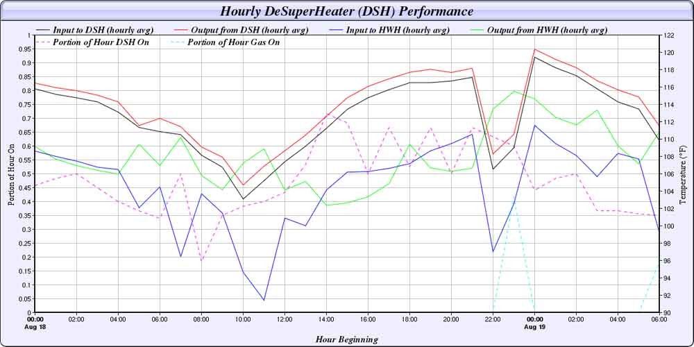

Here's a picture on how the DSH is supposed to work, this one for the past 30 hours.
In my case, my DSH Delta-T is only about 1.5° (difference between red and blue lines), due to the high incoming water temp to the DSH, due to not have a buffer tank.
Hope this helps.
Attachment: DSH.jpg

Please bear with me, sometimes the concept escapes me, and this seems to be one of those times. First, my plumbing appears to be exactly as the illustration that is above. I understand that the delta t should be 8-12 degrees. Is this measurement between the two 1/2 inch lines that come from the DSH, and travel above near the ceiling, or where the two lines actually enter the DSH?? I may be wrong but the chart above seems to have a delta t of about 2 degrees. The chart also seems to show the water temp from the DSH into the HWT to be very close to the water temp coming out of the HWT. Am I reading this chart wrong?? If this is correct, than the 1/2 inch line that leads to the bottom of my buffer tank from the DSH should be very hot to the touch. Both of the overhead 1/2 inch lines seem to be room temp. One of the reasons I am so anal about what I should be feeling, temp wise, is if I have this guy come back out, I want to know exactly what I should have, and wheather he is lying to me just to get rid of me. Sorry for my lack of understanding here, but contractors have been known to take advantage of seniors. (well, close to senior...58)

... the chart above seems to have a delta t of about 2 degrees.
... the 1/2 inch line that leads to the bottom of my buffer tank from the DSH should be very hot to the touch. Both of the overhead 1/2 inch lines seem to be room temp.
Yes, the chart above shows a delta T of about 2 degrees.  It's because I don't have a buffer tank.  In your case you do, and thus the advise of 8 - 12 °F for a Delta T.
I posted the chart to illustrate concept.  It needs to be interpreted and applied to individual situations.  I apologize for confusing you.
I'm measuring Delta T at the DSH (at the point the copper lines connect to the outside of the GSHP unit).
