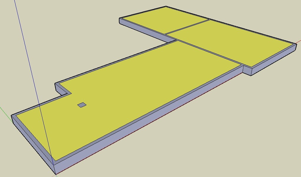

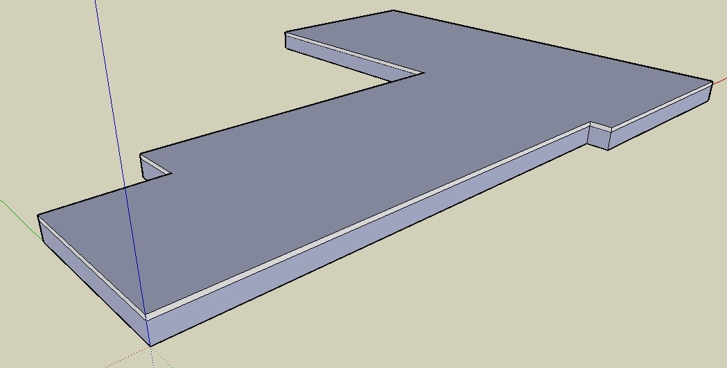

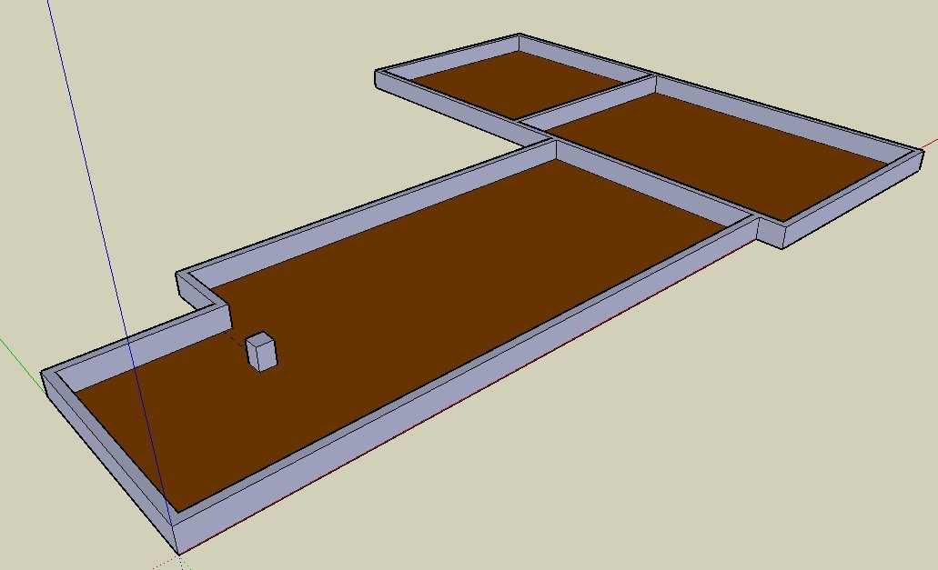

What I have in mind to do is build a perimeter foundation wall with CMU on footers, then fill it with gravel and sand, compact, place a slab on top of the fill.
The first pic would be the load-bearing CMU stemwall with concrete footers dug underneath (not seen in drawing). The brown part is grade, the grey parts the CMU, two or three courses (about 2 feet high total).
The second pic would be the foundation wall in grey, the fill sand in yellow all the way to the top of the CMU wall.
The third pic would be the slab (edge in white) poured on top of the whole affair (4 or 6 inches thick). Alternately I guess the sand could be filled to within 4 inches of the top, then the slab could be poured and the top edge of the CMU could be used to screed from.
Does this make sense? Have I got the concept of an elevated slab right?

I hesitate to recommend having a slab supported by foundations at the perimeter and compacted fill on the interior.  For me it should be one or the other.  If you get really good compaction, it will probably be OK, but there is an increased danger of differential settlement and slab cracking.
My preference would be to let the slab float inside the stem walls (also eliminating the cold bridge) as a "slab on grade".  You still need to do a really good job of compaction, but in my opinion there is less chance of differential settlement causing cracks.
Will you go up with ICFs above the slab?
Any chance of water getting tapped inside your stem walls?  Why are you reluctant to raise the entire pad and do a slab on grade?
Bruce
Posts:554
08 Jan 2009 05:58 PM
It will be steel SIPS above the slab (99% sure of that at least).
Ok I'll admit it, one major reason I don't want to raise the pad and do slab on grade is aesthetics. The raised floor home just looks better. Ok now that I've got vanity out of the way, it's also for comfort - I want to get my living space away from ground level. You can drive through several postwar parts of town and see slab-on-grade-ranch-home after slab-on-grade-ranch-home with the bottom two feet of the house covered in damp and moss. I'm sure plastic barriers help, but getting up and away from the spongy ground would be even better. The ground stays wet here for days at a time. Getting away from pests is another plus.
I don't trust using clay fill because of numerous problems (already discussed in that concrete floor thread). It's probably adequate if it's well compacted but I've known lots of people round here with problems when built on fill. Another issue is cost, where it seems like clay and gravel/sand are close in price, I think one would be using more clay if you're building up a berm with a gradual rise. It's more material being used (and more potential floodwater displaced). The gravel/sand would be limited to the footprint of the actual house.
But having said all that, I like to keep an open mind and I know I have to stay flexible if I'm going to get this house built. And I very much appreciate the input in this forum.
Anyway, Bruce, it does make more sense to let the slab float and use the stemwall as a screed. Wouldn't there still be a cold bridge though? I mean the CMU is concrete, too. I had planned to insulate the stemwall externally to combat bridging.

Posted By Jelly on 01/08/2009 5:58 PM
Now I understand.  I thought you were also planning to increase the grade around the house as well.
Accordingly, you will be putting an exterior finish on most of the stem walls, correct?  What will you do at the entrance(s) and driveway?
