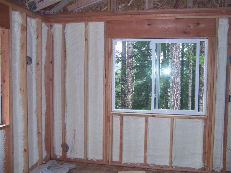

I used a DIY spray foam (tigerfoam) with fiberglass insulation in the walls.  One inch of foam stops all air leaks and eliminates any chance of a condensation point.  Then, you can get the FULL benefit of whatever less expensive insulation material you add.  I don't care what the "official" R value is, I just know that I heated my 550 square foot shop this winter with a 1,500 watt floor heater.  I needed a second heater when it was below freezing.

The thermal bridging of the studs?  I don't think most construction addresses this, other than offset double studs.  Adding foam as your first inch or two increases the R value so that you can live with the low value of the studs (R1 per inch).  I tried to put in 1 inch of foam, but it usually ended up averaging 2 inches.  That's okay because then cheap glass insulation for 2x4 construction (R13) fits perfect.  That makes a total R value of R25-27 as opposed to R19 glass only for 2x6 construction.
Probably as important is the seal the foam provides.  Stuffing glass into the stud bays looks like it seals, assuming your stud spacing is perfect, your studs are perfectly straight, your glass mat is perfectly straight, you don't have any electrical, you never have moisture in the wall, etc., etc.  The weakest insulation point for glass is probably right next to the stud, which is also where air movement is most likely and where R value is lowest.
It wouldn't surprise me to find out that 1/2 inch of spray foam and an R13 fiberglass batt (total R 16) would outperform straight R19 fiberglass in every situation.  Achieving the claimed R value of glass is dependent on there being no air movement or vapor transfer, neither of which glass provides.  Foam allows glass to perform as claimed.

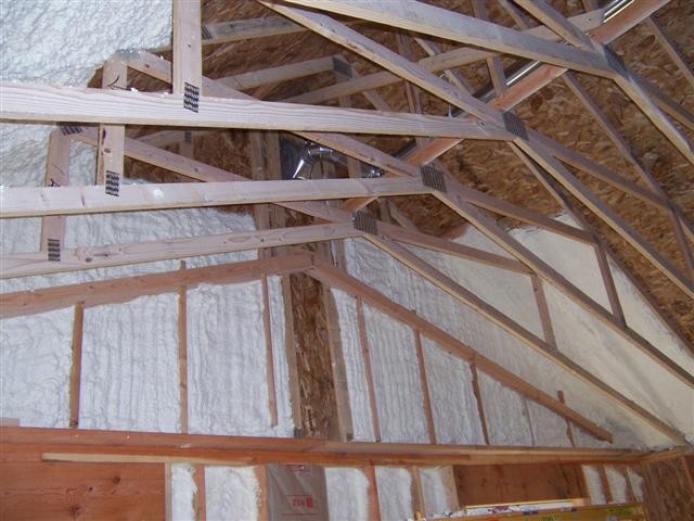

I did the research on an unvented attic with an air space under the roofing material.  I decided to use EPS foam between the trusses and then sprayed with foam to hold it in place and seal everything...
Mark, could you elaborate a little bit - you used tigerfoam for the roof as well as the walls? So on the roof, you attached EPS foam boards to the bottom side of the sheathing, and then sprayed tiger foam over that thick enough to cover the trusses? Did you find this more economical than just spraying all the way to the sheathing?
How was the tigerfoam to work with? Was it truly DIY friendly?

The walls had an inch of foam (more like two) and then glass for 2x4 construction (R13).  The gables were all foam, as they were trusses and didn't have any depth.  I started to foam the roof (under the sheathing), but it took lots of time and foam.  The foam goes on about 1/4 inch and that expands to one inch and stiffens if a few minutes.  Then, you can go over it again with another inch.  I opted to buy styrofoam panels and cut them to fit between the 24"oc trusses.  The insulation dept. of a big hardware store will have pieces of wire cut to length to hold fiberglass insulation against a roof betrween the trusses.  I used these to hold the styro panels in place.  Then, I shot a layer of foam, but when I went back over with the second inch, I pulled the wires (they bow down).  Perfect completely sealed roof.
My permit was for "unheated storage" above a garage.  Right.  The inspector saw the amount of insulation I was putting in and was only interested in knowing about foam.  I'm living there now while I build the house.  My experience is that the foam is way for efficient than glass, forget about the R value.  I don't have rafters or ceiling studs conducting heat out of the building and it doesn't matter how windy it gets.
Foam is messy stuff.  The walls weren't too bad.  The problem is that some nozzles just don't spray cleanly.  You should get plenty of nozzles with the kit, so change them out if one doesn't work right.  Get a Tyvek painters suit, wear clothes that you can throw away.  Mask and goggles.  Even still, I ruined a pair of glasses, until just the other day I found the miracle fix.

Mark, thanks for the details. So the only thing holding up the styrofoam panels is the spray foam? Is there a reason why you pulled the wires out? And will you have to sheetrock over the foam for fire protection?

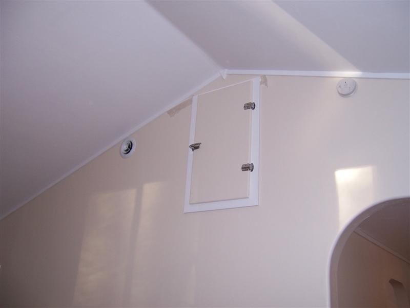

Foam is the only thing holding the styro panels in.  Although it's conditioned space in the attic, it's not exposed to the living area and doesn't need drywall.  In fact, my entire space above the garage is permitted as "unheated storage" and doesn't "require" any drywall.  I have scissor trusses, so the drywall is below the foam with no living area directly exposed to the foam.  There is a nice conditioned storage area over the part that doesn't have scissor trusses (essentially, the kitchen and bath area).
I pulled the wires for a couple of reasons.  First, they weren't needed after the first coat of foam and made spraying a nice even second shot more difficult.  Second, it looked better.  Third, I didn't want the inspector to know that part of the insulation was styrofoam (which has a lower R value).  In theory, if I applied later for an occupancy permit, I would fail because of insufficient insulation.  With 2x4 trusses, there's not much space to fill and I didn't want to actually put on the thickness to meet code for occupied living space.  My roof is only about R25 even though it looks to be more and, more importantly, performs to be more.  But performance isn't what a building inspector inspects for; they're only interested in a thickness/R value calculation, regardless of actual performance.  Without the wires, it's very difficult to tell that it doesn't meet code thickness.
One more benefit of foam.  It stiffens up the structure.  You don't get any code credit for it adding to the shear performance of walls and truss roofs, but it performs like having hurricane straps everywhere.  There's nothing to worry about with "only foam" holding the styro panels in.  We slept through a big wind storm with trees falling over, and didn't hear a thing or have the building creak and moan (the neighbors moved to their basement to sleep).  I hate to think how difficult it would be to demolish a foamed structure.
The secret fix for getting foam overspray off of glasses is bronze wool.  I was using it to remove lacquer off of a brass saxophone without scratching the underlying brass.  I thought of my two pairs of glasses that I ruined when foaming, and sure enough, it took off the foam without further scratching the glasses.  Now, I've got extra glasses everywhere.
Foam's not cheap.  I'd use it even more sparingly in the future, but I'd still use it.  For a bigger project, I'd hire it out.  I did a ballpark calculation and figured it would cost three times as much for me to foam my project as against just fiberglass insulation.  By using a combination of the two, it can be brought down to twice as much or maybe slightly less.  You have to need, want, and understand the benefits in order to pay twice as much.  Even though foam is kind of a pain to deal with, it's still better than putting in fiberglass.  Unfortunately, it seems that both are necessary for the best cost/benefit insulation system.
Here's a picture of my attic access.  I found a whole bunch of icebox hardware on Ebay, so that's what my cabinets, closets, etc. have on them.  The arch is foam.  With the scissor truss ceiling and arched passages, what would have been a box-like storage area really feel nice.

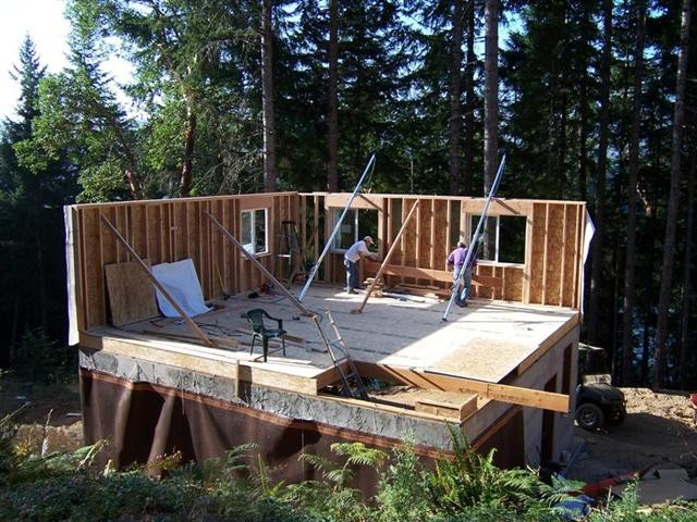

Forgot.  I'm in the Seattle area.  The reason that there is sunlight on the walls in the picture is because we have a southern exposure on Puget Sound.  That's light reflecting off of the water.  Interesting rippling reflections.  The vent by the attic access door is part of the HRV system that exchanges the air several times a day, really important for a tight structure.  It even exchanges air in the garage below to remove gasoline vapors, humidity from the concrete slab, etc.
Not your ordinary unheated storage space.  I actually had the upper floor listed on the permit application as a "studio" as in art studio (painting and ceramics, so lots of noxious fumes, smoke, etc., hence the HRV).  The county didn't like the word studio and made me change it before issuing the permit.  But they didn't make me change the plans.  What?  Okay.  Strange.
Mark,
I respectfully disagree with your statement above. I would submit that glass is a great conductor of heat energy. Why spun glass fiber can have resistance to heat energy transfer is if it is fluffed up and thus has trapped air pockets. When you put in two inches of foam into a 3 1/2" space you have 1 1/2" left. When you compress 3 1/2" of fibergalss into a 1 1/2" space you have much less than half of it's stated "R" value due to the lack of trapped air pockets.
