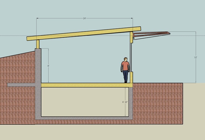

I am very interested in building an earth sheltered home.
From what I have read so far, you want the insulation, and waterproofing on the outside.  So it goes, from inside to outside: concrete, insulation, waterproofing, protection / drainage layer, gravel, earth.
This gives you a large dry interior thermal mass that is insulated from a constant exterior temperture of 55 degrees.
I have started to read about aerated concrete and am trying to figure out if it would be a good option for the wall.
It is waterproof.
It has a higher r-value than concrete.
Reduces thermal bridging.
It is vapor permeable, so it breathes.
I think that these are good qualities, from what I understand, you want your wall to dry from the inside and I think the AAC might be less damp than regular concrete in this situation.
I may be completely off base and it may be a stupid idea.  It may not be strong enough for a retaining wall.
Thoughts?
Attachment: section.jpg

Hopefully someone with more knowledge will jump in here, but one thing I can contribute is that AAC is not waterproof. I have no idea if it's strong enough for a retaining wall, but you can reinforce it by placing rebar down into holes into the AAC then grouting it solid.

I have built earthsheltered since the early 70's and I have extensive experience worldwide with aerated cellular concrete.  I am not saying all of that makes me an expert but I would caution you to study some more.
AAC is NOT waterproof and when you aerate concrete you weaken it significatly.  These things can be mitigated with proper engineering design but that is done by a qualified professional.  Even professionals make mistakes  (look up how Ken Kern died for instance)
AAC and aerated cellular both have their place but probably not as a below grade foundation/retaining wall--at least not without very qualified engineering oversight.
