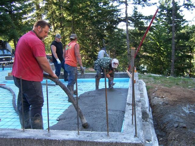

I've gone with concrete because I need the mass for my hydronic heat.  Any biofriendly calculation depends on how many issues you can address, and thermal mass isn't in most people's equation.
