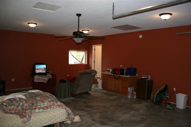

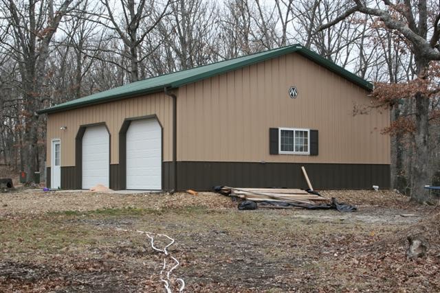

Although it started out as something quite different, we ended up with a very comfortable cabin that is quite energy efficient for around $30,000.
We started by building a 30x36 Morton building. This is a 'pole barn' with metal siding and metal roofing. The walls are supported by 6" posts every 6 feet (I think; might have been 8'). Roof is supported by prefab trusses. We prepared a pad with local rock, and the barn went up in a day. They came back the next day and poured the concrete slab inside the barn. The original intention was to use this to store our camper and other toys while we built a house on the land. When we decided to wait a few years on the house we started to do some finishing of the barn.
I built 2x4 interior walls between the structural posts. This left a gap on the back side between my wall studs and the exterior wall stringers and siding. We hung 6" fiberglass batts in the wall and let the glass fluff out into the gap. After wiring, drywall went up. We built an internal wall to separate one garage bay from the living area.
For the ceiling I used joist hangers to hang 2x6 rafters between the trusses. We hung drywall then blew 48 bags of cellulose into the attic.
Because we were worried about freezing in the winter, all of the water is contained in the bathroom and the pump room. The interior walls were insulated around these two rooms, and we intended to heat them with small electric heaters during freezing weather. Because I didn't want to dig up the concrete, we built the bathroom up off the concrete slab. Because the barn has 10' ceilings, there's still plenty of headroom in the bath, and the pipes run under the raised floor.
For primary heat we installed a wood stove. We tend to leave a window open when heating with wood, because to get the stove hot enough to burn efficiently, raises the temp inside to uncomfortably warm levels. Interestingly enough, the main room of the cabin has never gone below 35 degrees (F) in over 5 years, even without ANY heat. We're located in central Missouri, and we've had below-zero temps for prolonged periods. I believe the earth beneath the slab is warm enough to keep the main room above 32 even in the coldest weather.
In the summer we can open the garage door for summer breezes. We purchased a screen that covers the entire door opening.
The Morton building and slab was around $19,000. I did all of the finish work (except drywall) myself. Excluding the underground electric service, well and septic tank, finish work was less than $10,000. We ended up with a very comfortable, zero-maintenance cabin.
