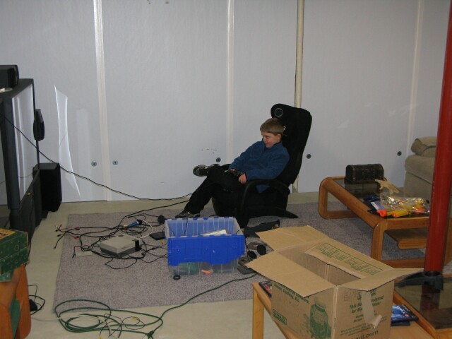

I used a product made by DOW called Thermax. They sell it in many different configurations and I purchased one of the least expensive forms and I'm quite happy with it. I have a 2,400 SQ-FT basement and so I needed a lot of it. I also have 9 foot poured foundation which is even more expensive. With code you can insulate the ceiling or the walls in the basement and I chose the latter. The insulating contractor will normally glue these panels to the wall but I chose to screw them so that I can take them off the wall. What they are is a foil on one side, fiberglass compressed in the middle and foil with a white plastic on the finished side. They are 1.25 inch thick sheets and are r-10. To do my basement by a contractor was over $7,000 but I found the distributor and purchased the panels for about $32 a 4x8 sheet.
