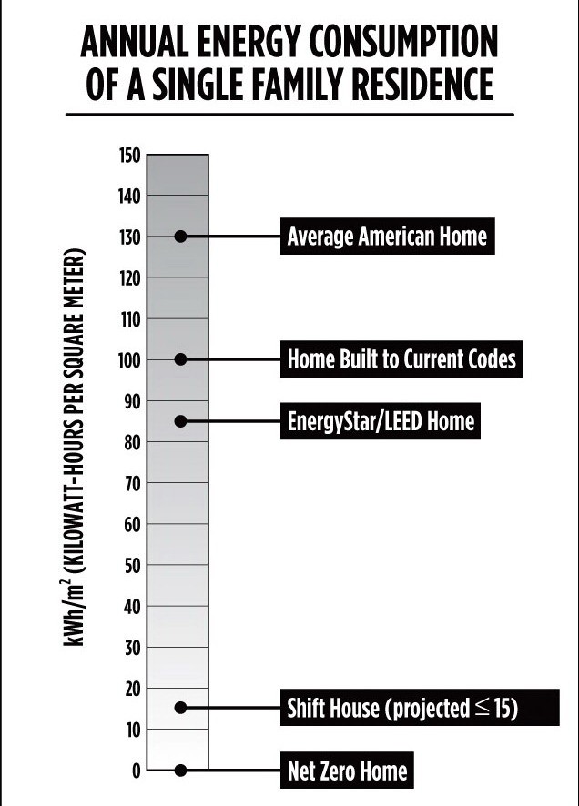

Saw this chart and wondered if we are all just Stupid or just unaware of the facts. I think that we should strive to make positive change with all our might and no pussy around with so much effort on this mediocre LEED Standard that everyone is working towards. Look at the Chart below and smell the Roses.
Attachment: lede2.jpg

Just to clarify,  LEED is not a standard.  It is a voluntary "scale" that measures sustainability (of which energy is just one component).  LEED's rating system is consensus based and relies heavily on industry (design, construction, etc.) support.  If the entry level is set too high, very few will support it.  LEED (for new commercial buildings) is in its 3rd generation, and with each generation, the bar has been raised.  Whether or not it is a "hoax" depends a lot on your perception and expectations.
I don't know if the numbers on the chart are accurate or not, but lets assume they are.

Your chart seems to show that an energy star/LEED house, which one can assume is the most basic LEED rating, uses 15% less electric than a code built house. This house would also use much less water than a code house, have less runoff, contribute significantly less waste to the landfill during its construction and over its whole life since it would be more durable, would have a longer lifespan would probably house more people per square foot while using less land due to the bonuses for certain percentages and ratios used to score such things and would certainly be easier to sell since it would be cheaper to live in and healthier than a theorectical code house. Did i mention it would probably be good for your karma? I am going to go with "unaware of facts"

The primary "issue" with LEED, is that as a prescriptive-only methodology it is as theoretical as the baseline model.  Real efficiency should be measured (& corrected, where shortcomings are found.)   LEED structures as-measured are all over the map,  with the theoretical benefits often missed.  Any standard that does not require a performance measurement is a sub-standard standard, IMHO.
Separate from LEED, any standard that focuses on annual energy per unit of floor space has a fundamental flaw, that often comes with perverse consequences.  Smaller structures typically use less total energy, but more per unit area.  (This is a function of geometry:  The ratio of exterior surface to floor space increases as the structure shrinks.)  The total amount of resources to build the larger structure are greater too.  Is annual kwh per square meter really a useful metric of sustainability?  (Methinks not.)  In a dwelling or office, a per-occupant standard seems more relevant.  (Four person families in a 8,000ft^2 LEED-platinum or EnergyStar McMansions is not necessarily a standard to embrace.)

What I thought the Chart was showing was that, we are not trying to solve the Global Warming thing y, but only dragging our feet on the subject. What we should be striving towards is the NET ZERO Standard and STOP making the LEED such a big deal.
14 Jul 2009 05:13 PM
The chart shows that the LOWEST level of LEED is = to energy star. Maybe if it included averages for all the levels of LEED it would be a better basis for this thread. I don't think the Green building concils main goal with leed was to stop global warming although reduction in greenhouse gasses would be a likely for the majority of LEED homes. Ergo you asked the question. Do you think it a "hoax"?
I think it's a lame effort towards Energy Efficiency in building construction overall in times when we should be trying to do our best. these Leed efforts seem to little to late. My opininion, whats yours? Here we go deeper in Leed, geezzzz. http://www.jetsongreen.com/2009/07/the-concept-of-leed-decertification.html
