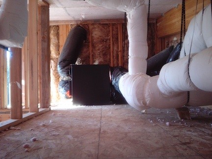

I presume you are interested in a picture of the actual HRV interior installation as all the outside images show are.....the Seiho vents.

Yes, please. The interior system pics is what I am looking for. THANKS

20 Aug 2012 09:44 PM
Here it is

Is that attic within the thermal envelope of the home?

Yup.
