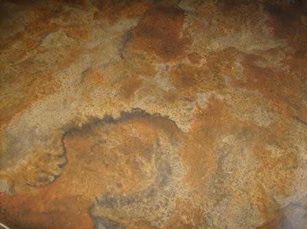

Check out Sim STain Simulated Acid stain www.simstain.com we have been using it for years and have had no problems and it hold up great.  I have attached a photo of a recent job the stain is water based, enviromentally safe, and has little to no VOC so it great for LEED certification.  They have 24 + colors that are UV stable for exterior or interior use and you can use what ever type of sealer you want over it.
Attachment: stained floor technique used with plastic.JPG
