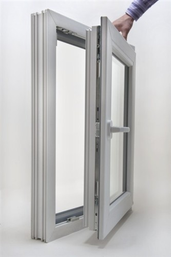

If one looks at the whole window design technology, it is no secret that U.S. windows are well behind the learning and energy curve of European windows but companies like Intus (Washington DC) who utilize European engineering in their windows, are an alternative.
This also translates to our doors. If you ask any green build engineer, finding a high quality door here in the USA is very difficult if not impossible. German doors are built to a much higher quality standard than typical U.S. doors. Nothing like building an "energy" home and then having a 3' wide by 7' tall thermal hole in your home, aka the front door. The main drawback to German doors is that they are very expensive. The other option would be a Polish designed door. Drewexim doors are manufactured in Koszalin, Poland. One U.S. importer and distributor of Drewexim doors is Fenestrations Plus of Bangor, Maine.
Once you see a real window design like this Intus, when it closes and locks like a bank vault, you will never look at American designed windows the same.
