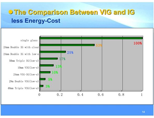

Very good U values and triple glazing is standard. The importer here in Toronto can get the frame only if desired and a spacer so we can put in whatever glass we want. On Tuesday, I will get a sample of the Vacuum Insulated Glass from China. They say they are using Guardian glass and the thickness will be 10mm for double space and 24 for triple glazed (not sure why double is 10 and triple is 24mm).
