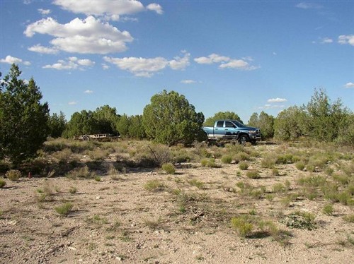

Posted By Lbear on 21 Aug 2012 04:32 PM
Posted By Dana1 on 21 Aug 2012 03:19 PM
That very-local reflectivity won't do much for smokin' you if it's the north side of the house though (which is what I thought Lbear's scene was represented.)
That shot is to the south, where the majority of windows are.
In that case, what does your south side yard look like?
Concrete paving/sidewalks can be quite reflective, as can alkaline hardpan soils common in AZ ( caliche, etc. )
Posts:2740
22 Aug 2012 05:40 PM
Posted By Dana1 on 22 Aug 2012 11:39 AM
This is the site pad:
Dana1User is Offline
Posts:6991
27 Aug 2012 03:26 PM
The bare soil appears to moderately reflective- enough to add something to the mid-day gain. Iif that's facing south I assume the photo was taken at ~8AM(?), give or take, based on the shadows?
Posts:2740
28 Aug 2012 02:35 AM
Posted By Dana1 on 27 Aug 2012 03:26 PM
Actually this is NORTH facing, the south facing was the other photo.
