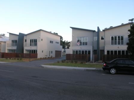

I know this is an old post but I had to get some good news out .... we just finished 12 townhouses (two storey, three bedroom, two bathroom, double garage average 130m2) in a coastal town about an hour south of Sydney using ICF's downstairs and three inch thick styrene screw fixed to timber studs upstairs with a metal roof, nice italian double glazed windows and groovy internal doors (also from italy).
August 2006 the bank valued the units at $430,000 each (while the market was still going reasonably well);
Delays due to weather, a lot of experimenting with new products and materials, getting rid of shotty tradesmen etc the project dragged out to 21 months!
Welcome to May 2009 - we are all in the guts of the GFC and we are expecting a backlash from the bank when four independent valuers representing four of the five investors in the project all needed to refinance so they could release the original mortgage and lease out their finished units.
All four valuers came in around $490,000 !!!!
That's a $60,000 increase in valuation when everything else around town has been culled by 20% in the last six months !!!!!!!!!
THey weren't paid any backhanders, there was no alcohol involved, no sweet talking just an in depth explanation of how these townhouses were built and the two main advantages of building with ICF's are unfortunately intagibles .... but that day it was 35oC outside and they all commented on how quiet and how cool it felt inside.
This proves to me that even though we are ten years behind the U.S. in ICF market penetration, the educated people representing banks understand that quality commands a better dollar.
