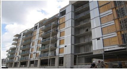

Bovis Lend Lease, world wide developers have discoverd the benefits of steel SIPs being  used for the perimeter curtain walls on this eight story building in Tampa.
The project manager stated that the panels exceeded their expectations and saved several months constructiuon time over masonry construction

Nice!  I assume the panels are facade cladding, not part of the building structure, correct?  Are the windows also unitized or are they site assembled?
Is the interior panel face finished, or is it then clad with drywall?
I would like to see a panel section and a joint detail, if it is available.

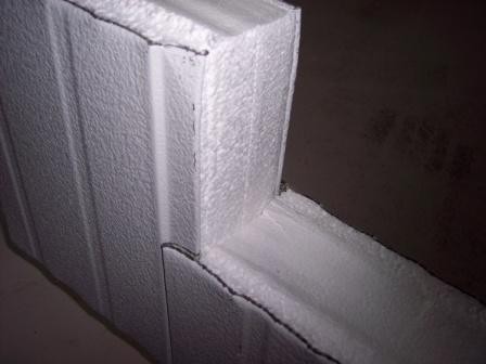

Bruce;
they are in-fill walls, held in place with 2- 2" x 2" 18 ga. steel angles fastened to masonry
any type window would work
the interior face is to be drywalled as is the rest of the interior
Each panel is 45-1/2" wide the picture shows the friction fit T&G joint , no fasteners required!
