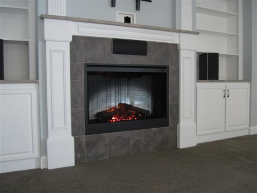

Here's a shot of what I ended up with:
It's an electric fireplace by Dimplex.  People who have seen it think that it's a gas log fireplace until they take a closer look.
I plan to mount a 55" HDTV over the fireplace at some point.  The black rectangular shape at the top center of the tiled area is the center speaker.
galnarUser is Offline
Posts:83
20 Jul 2010 12:24 AM
I love your mantle, tile surround, and built ins. Do you have a Picasa or Flickr account with more pics of your place?
ClarkUser is Offline
Posts:248
21 Jul 2010 06:37 PM
Posted By galnar on 20 Jul 2010 12:24 AM
Thanks, for the complement, galnar.  Yes, you can view more pictures here.
Posts:248
19 Dec 2010 10:28 AM
The bottom edge of my 55" Samsung LED TV is 62" above the floor. Neither my wife nor I spend extended periods watching TV, a couple of hours at a sitting is about the max. I haven't noticed any neck strain issues. I did install the TV with a slight downward tilt to compensate for the high viewing angle. If you view the TV from a recliner, the high positioning of the TV is actually a good thing. It's also ideal while watching from a standing position, like when preparing food or washing dishes (our big screen TV is viewable from the kitchen).
My fireplace liner is the Dimplex Opti-Flame 45" model which I bought on E-bay for $840 including shipping. It has a built-in heater and replacable air filter. The new Opti-Myst models are a step up the realism ladder. They use an atomized mist of water to simulate a 3-D flame and smoke (but not the sound of burning logs). The water evaporates into the room air space which is desirable in most homes in the winter. In my super-sealed house, I need to work to keep the humidity down year round, so the Opti-myst would not have been my best option, had it been available at the time. If that's not a problem and you can afford the ~$2000 price tag, it sure is a remarkable electric fireplace.
