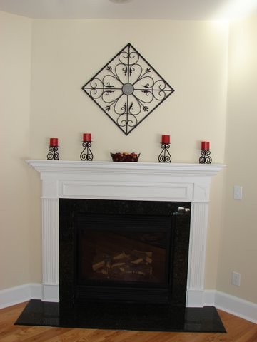

Thanks for the response!  We have ruled out the pellet stove for the main floor since my original post.  We went through a craftsman style house & really fell in love with a fireplace mantle, so that made our decision.
We're not finishing our basement right away, but when we do I'm still considering the pellet stove to heat that area.  In that case, the power failure issue concerns me less - downstairs is going to be rec room/bar/etc.  Probably not something we're going to be using when the power is out anyway...
Here's the fireplace we're doing, if anyone is interested (tile is going to be different - I think we're going to do 6x6 slate)
