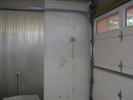

I think I just saw and article in ICF builder about adding electrical in a finished ICF house, did any one else? Similar to termites,I discovered carpenter ants in my ICF garage wall, on the inside. I did some checking and I believe they came to the garage because of the 4 yds of mulch I put on that side of the garage. They say that carpenter ants make a home where moisture is present and I just pressure washed the inside of the garage, ICF walls covered with corrugated sheet metal. I figured the water couldn't’t hurt and I have done it before. It was pretty easy to vacuum them and fix the EPS and I put poison bait out for them, just think if it was wood framing, they would have ruined the wood and they would be difficult to get.
Attachment: ants.jpg
Bruce FreyUser is Offline
Posts:338
27 Jun 2009 10:27 AM
Hi Brad,
I like your corrugated metal paneling.  Where did you get it?  Do you know the guage?  How wide/deep are the corrugations?  Panel size?
Bruce

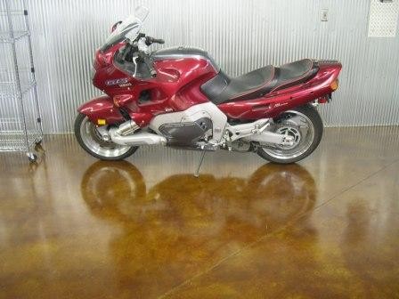

ICFconstructionUser is Online
Posts:716
27 Jun 2009 10:40 AM
Metal sales (national company) has the corrugated panels in two foot increments. It is available in a couple gauges, mine is light, but enough. I used "aluminum" colored silicon to seal it to the floor. For heavy stuff like the can crusher and bike rack I used aluminum diamond plate so as not to dent the paneling.
Attachment: bike in garage..jpg
