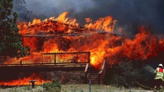

Estes Park, Colorado home burning - June 23, 2012

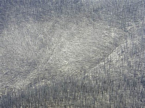

This is a pic from the New Mexico wildfire, man, that is a sad site to see all those trees burned. Looks apocalyptic, like a nuke went off.

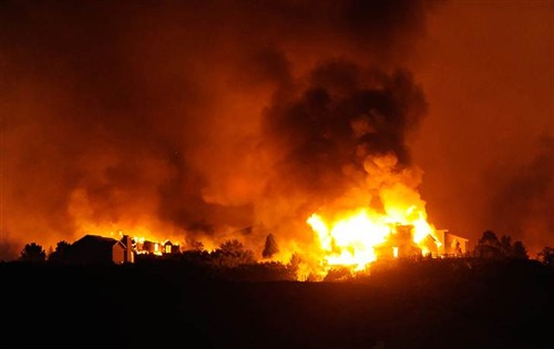

This picture was taken on June 26th in Colorado. You can see two homes burning in the background. The embers travel so far and find their way into the eaves and soffits of the homes and sometimes the homes start to burn even before the actual fire is on top of them. Once the fire is inside of the homes wood walls and wood trusses, its over. You figure they would at least put cement board or stucco on the exterior walls but a lot of those homes had wood siding and paneling on the exterior.
The ICF and Steel SIP industry should really make their presence known in those areas. Most people never heard of ICF or steel SIPs and figure their only option is to rebuild with wood again. One thing is certain, the lumber industry reps will be out there in full force ready to make a killing on rebuilding in wood again. At least if the property owners know that they have an alternative building source utilizing steel or concrete. This gives them the choice, most don't even know that there is a choice.
