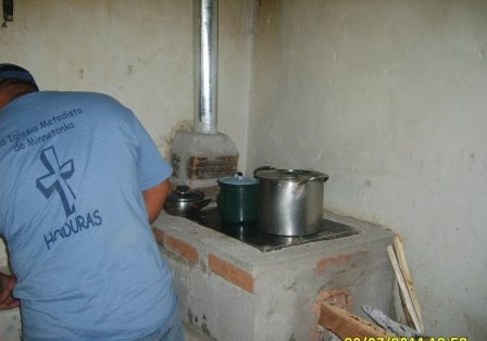

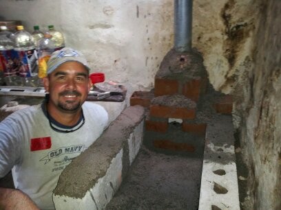

2 weeks ago I was involved with a church missionary team that built 20 efficient stoves in 5 days to the village of El Pariaso, El Paraiso, Honduras
wood is the primary source for cooking
cost of materials are about $100. USD each
Commonly known as "Rocket Stove Design" , they are 70% efficient, smoke was eliminated from the households, providing a huge health and economic impact to the families that received them

Posts:3360
08 Jul 2012 07:04 PM
SciGuy;
Not true the stoves we constructed had heat directed thru a combustion chamber under a 24 x 36" Plancha, smoke was directed thru a simple chamber to a 4" uninsulated galvanized pipe (no damper) The temperature at the front of the plancha was 450 deg. gradually reduced to 200 towards the chimney and the 4" pipe itself was cool enough that you could put your hand on it momentarily, about 130 degrees
