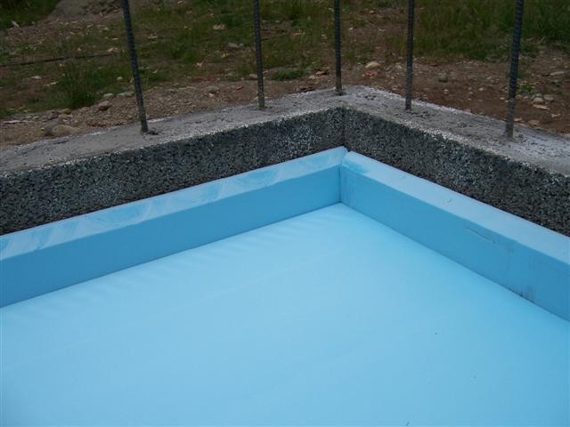

R10 insulation under a concrete slab is required by code for occupied space where I'm building.  2" Dow Blueboard is the preferred material.  It has higher R value and is more durable on the construction site than the bead type.  Contact a real material supplier, not a home center, and get the 4x8 sheets for any larger job.  It will cost you $1 per square foot, which is why some contractors say you don't need it in the middle.  Some jurisdictions may allow you to tape it and also call it your vapor barrier.
I think that leaving the center uninsulated as a "heat sink" is one of those silly fairytale construction myths.  I can't believe that it's still repeated and some jurisdictions allow only the first several feet around the perimeter to be insulated.  The earth's temperature under your house isn't what's important.  The issue is whether there is any moisture transfer under your house.
Here's how you tell.  Are there any live plants growing around your building site?  Then there is moisture moving through the soil.  Or, try this.  Place a plastic tarp on the ground the size of your foundation.  Collect the gallons and gallons of water that condenses on it every day.  That's how much water is moving through your soil.  Now, heat that water and throw it out the window every day.  That's what a "heat sink" in the center of your slab is doing.  End of rant.
Mark
Attachment: 101_1185 (Small).jpg
