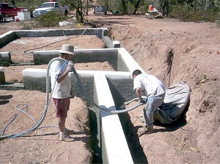

Why not just use EPS Foam with a GFRC skin coating such as this
Attachment: ScreenShot2009167a.jpg
Posts:5341
11 Jul 2009 02:43 PM
If I understand the picture correctly, it shows a foundation with footings that would not work with the very low PSF loads that unstable soil needs. Ie, the idea is to spread the weight of the house over the entire area of the house.

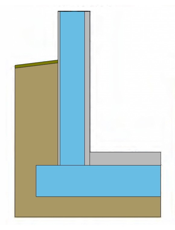

Yes foam is way less expensive and the savings in temp loss will also add up in the long run. Here is another idea that might work better for you.
Attachment: AVIA-1a.jpg
ErgoDeskUser is Offline
Posts:149
11 Jul 2009 04:33 PM

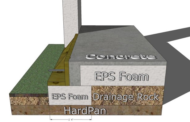

OR, or you could do it the HARD way, this works only if you get cheaper labor.
Attachment: Super Insulated Basement Slaba.jpg
Posts:5341
11 Jul 2009 05:27 PM
great drawings, thanks.

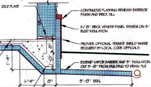

So here is how to do it right, a save BIG Bucks.

Posts:5341
11 Jul 2009 07:15 PM
Here is what I am thinking that is easy and has the thickened edge for strength (most of the weight is at the edges of the slab).  Plus post tensioned cables through the concrete.
Attachment: foundation.png
Posts:149
11 Jul 2009 07:26 PM
I see you have the concept, you don't need a very thick concrete slab on the EPS Foam 1.5" reinforced would work fine.
Posts:5341
11 Jul 2009 07:34 PM
I believe that 8" is about as thin as they go for structural foundation slabs.    5" for post tensioned tennis courts.
