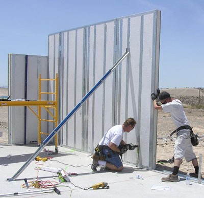

ErgoDeskUser is Offline
Posts:149
17 Aug 2009 07:42 PM
KWIK-BUILD PANELS WALL ASSEMBLY
Attachment: wallassembly2.jpg

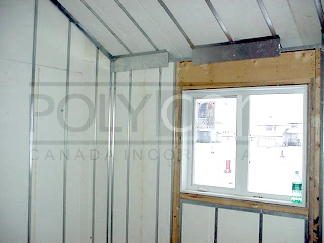

PolycoreUser is Offline
Posts:79
18 Aug 2009 10:50 AM
Here is an updated photo of a Polycore build. The image below is about 5 years old and shows a wooden header above the window. Polycore Canada Inc has worked hard to adapt our product to eliminate all thermal bridging and reduce the use of lumber. Notice the use of a metal lintel plate replacing a conventional wooden header.
Attachment: FB window.jpg
Attachment: Main floor.jpg
