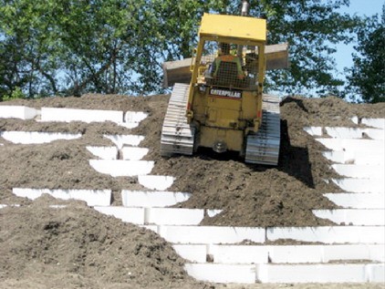

The 2 lb. is all you need unless you are building a skyscraper.
Attachment: ScreenShot2009123a.jpg

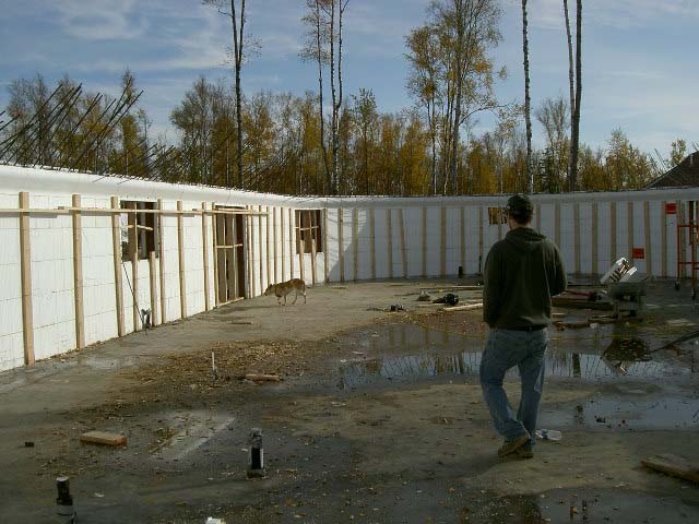

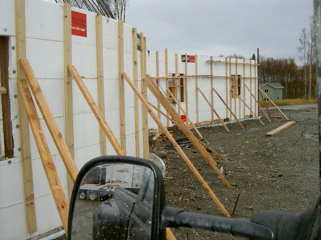

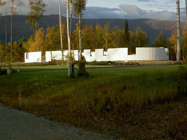

I ended up using XPS under the interior part of the slab, I think it was something lijke 25 psi and I used 60 psi EPS under thickened edge part of the slab.  I used the xps around the vertical edge of the slab and a mixture of it for "wing" insulation.  (Stuff I had left over)  heh
And the ICF walls are up....just waiting for the monolithic dome roof now.

GreginAlaska,
Be sure to post a picture of the monolithic dome.
