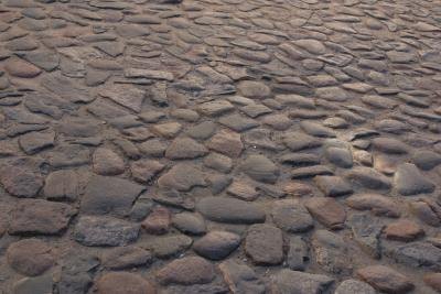

Here is something similar (notice the black fabric):
Posts:3338
23 Jul 2012 06:49 PM
Or this:
I'm not adverse to some kind of stakes to anchor everything to the slope.

When you say "stones, 5" average", are you talking about something like flagstones or river rock or quarry spalls? It seems to me that river rock would be terrifically slippery and the natural action of tires will be constantly digging stones out. You would get similar with quarry spalls or railroad ballast, but you would have to expect that the surface would fill in with local dust and dirt over time.
Those pictures you supplied are of erosion slopes. Don't expect to do the same thing for a driving surface.

Hmmmm...steep slope, major runoff.....a road like that is nothing to fool around with. Maybe an engineer is in order.
Surfaces like the two you've shown are fine until the ice and snow comes, then they are horrible and can't be plowed.

I saw a couple questions about freeze/thaw & snow/ice, but no response. If this is going to be in an area that gets snow it looks like it would be a nightmare to shovel/snowblow & probably impossible to plow. I'd be concerned with ongoing maintenance as much as the initial install..
It reminds me of those river rock shower floors that everyone wanted a few years ago. They look cool, but once you stand on them you realize that they SUCK.
