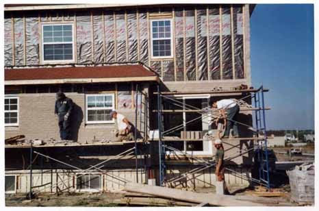

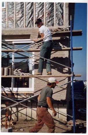

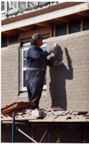

            We used Novabrik on our Icf Home I live in right now, 2 full walls of 18' x 28' and a wall of 53 x 18'
covered to -+ 50% ( windows and Door ) costed 6095$ in brick/Ledge/corner stones ....
Took us 3 weekend ( 4 to 6 person ) to do it, with 0 experience....
lemme know if you want Photos...

Here are some Photo's...
Don't mind the typar, my father was very anal about it...
Attachment: NovaBrik1.jpg
Attachment: Novabrik2.jpg
Attachment: Novabrik3.jpg
