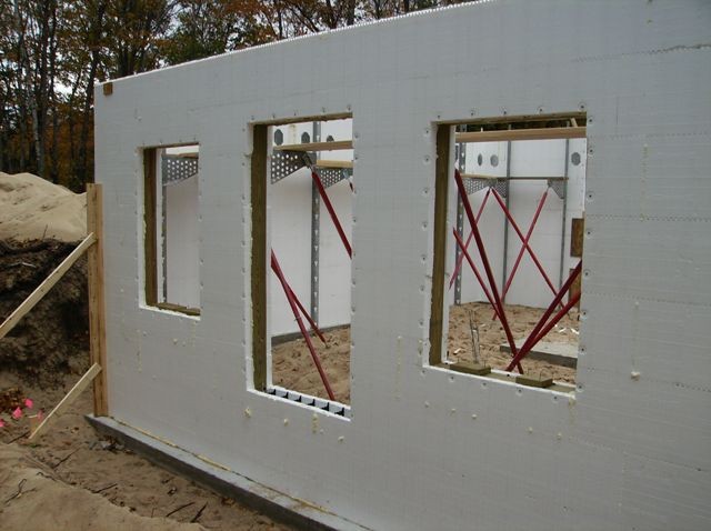

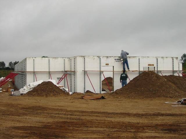

Reply: Sly there are many reasons why we teach this method of bucking. First though I will point out a few reasons why some don't use this method. Some ICF's have to much compression to use this method, and many of the professionals on this site do the ICF only on there projects. Most of our customers are the ICF guy and builder and are still around when the windows go in and can simply understand this method and make it works well for them. The ICF guys are long gone when the windows go in and surely don't want to create a complaining contractor who doesn't understand this method.
I will enclose two pictures which will include the original picture that is being poured that you commented on and a closer up version of another to help understand the procedure. The benefits of an inside buck are as follows:
(1) No cross bracing of windows required which saves time and also impedes the workers from entering in and out of the doors and or window openings in a basement or on grade pour.
(2) The inside buck's shown are 2x6 Pressure treated which require no ripping in which power is not always available at an early stage of construction.
(3) This single buck method along with even a re-wrap is still less material cost than a 2x12 PT.
(4) This method allows you to install huge window openings by yourself one piece at a time.
(5) There is allot of room for error in the double buck application. (inner with a re-wrap) If you made an error which was discovered at time of re-wrap you simply add 1/2 or 3/4 ply to one side or the other to make up for the mistake.
(6) There is no thermal bridging with the single or double buck method. (explain further on)
(7) No warping of material at all!
As far as the methods goes first you will have to make the choice between single and double. Double will be the same principle as single but with a 3.25" larger R.O. As stated above the lumber in a inside buck is 2x6 (6" wall core) with the top (header) going across the top of the sides, the sides going under the top and beyond the sill, and the sill fitting in-between the sides.
If you pre-assemble the bucks together make sure you only screw the sill first on the inside and continue stacking block until you have crossed your window sills and your blocks lock in the correct running bond. Save the screwing of the remainder of the windows until wall alignment is in place and windows are square and plumb.
The bucks are screwed into place from the inside first with a 4" galv. coarse thread screw and a 402 ULP as shown in photo from Windlock at 8" o.c. Next we fill the gap between the outer ICF panel and the PT 2x6 with foam adhesive. By time you get all the way around the house the first window is generally set up. Next screw the outer foam in the same fashion with the same exact, and opposite pattern. You will be slightly inverting the ulp from its original convex design to concave. When you screw the outside screws the torque will slightly bow the foam in which allows the nailing flange on the window to be a little more flush with the foam.
Next if your going single buck you simply remove the outer screws and use them to screw the window in place. If your going double buck you can either re-wrap the opening with two 2x6's white lumber side by side which equals 11" again no ripping and a reason that works well with our forms. Or, you can place a 2x6 white lumber flush with the outside and a 2x4 flush to inside and fill the gap between with foam to impede thermal bridging.
Is there thermal bridging through 2x12 window bucks? There has to be some, we can easily see it in a infra-red scan of an ICF home at the top plate when it isn't recessed like single inside buck window method in photo and also see every outlet that is cut all the way to the concrete surface.
Next make sure you double buck your door openings or see next paragraph. You will want to have lumber to hit with your two long hinge screws that are provided for the top hinge. I would recommend replacing two screws on all hinges with the matching longer screws along with the doorknob strike plate which can easily be kicked in which will split the jamb with the standard 3/4 screws provided which don't reach the RO lumber.
You will also have to decide how to jamb your door openings. Doors with standard jambs will swing and hit the RO when half open if held flush to exterior with brick mold applied. Options here are many depending on door manufacture. Some hold door flush to inside and jamb exterior, and some flush 2x4 or 2x6 with 1/2 ply wood flush to ICF interior. This allows a factory jamb and sill, in which fore-thought can achieve many exterior finish options.
I will leave off with this and answer any questions you have.

Sure does look like a lot less work than 2 x 12 bucks! Obviously the screws every 8" must provide enough rigidity to keep the hydraulic pressure of the concrete from bowing the bucks or you wouldn't do it this way, right? I take it the foam adhesive is rigid enough when it sets up to keep the outer panel from bending in very much when you screw the buck in.
What do you do for the sill buck when you have the ties right at the bottom of the opening, like in the one window you show?

Good question, that is also something I commented on in my early a.m. post yesterday that I lost due to the large picture. This method allows you to remove any ties immediately below the sill piece due to the buck is replacing the tie strength. Also note the small beads of glue on the horizontal block joint below the sill, this keeps the concrete from lifting that block up. The foam adhesive on the outside will crush and bow in to much if over tightened, but the glue does a good job of holding the outside without over-tightening.
Yes the screws keep everything dead solid. I have only seen one buck move on a double garage door opening where I was pouring for a first timer. I was filling the column between the doors and didn't realize the customer hadn't ran the buck down into the full block below the opening 6" or so. I was trying to use up the first wet load about a 8" slump with a new pump guy that was sitting on a very steep slope, which has a negative affect on the operators handling abilities when the truck isn't level.
He could not move quick enough and I filled the column all the way to the top. The side couldn't hold the wet head pressure and pushed out which was easily manageable.

Hello Dave, your pics do not show any support unter the lintels? Looks like some of the windows are maybe 4' wide or so and your lintels look to be 20" or so deep. You can actually pour and the lintels do not bow due to the weight of the concrete?

Bunt, yes windows over 3'6" need header support by either a vertical 2x something, or a horizontal support by a strong back method. Personally I quit using either many years ago. Trying to be cost effective and proficient ICF installs taught us neither method made sense, you would continually shrink your lumber lengths by cutting them to fit the next smaller window until you bought new again. We simply place a vertical ICF brace in the center of each opening and screw a block of 2" x 6" (the same ones over and over) to the back of the alignment/brace through the slots to hold up the header. As I'm typing this I looked in my laptop for a photo which shows this in which I couldn't find and I'm sure I have one at work which I will add later. We allow about 1/8 th inch compression out of our brand of ICF in which we simply leave it that much short before pouring.
