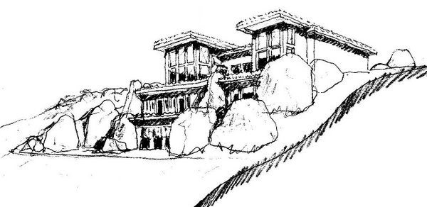

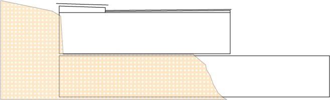

Hey guys - Ive got 2 stories that set back into the hillside. The bottom floor is kinda like a walkout basement so it retains hillside on 3 sides. The main floor only retains in the back. It's a stepped hillside ( see attached image)

here's the rest - the pic cut off the post -
So the question is - the engineer Im working with says that rule of thumb for concrete walls is 1" for each foot of wall height -So assuming 2 stories at 9' each Im at 19' give or take - so rule of thumb would be a 19" wall????
Im located in the santa cruz mountains in California so siesmic is a concern.

We are currently working on a 3 story home in Washington in a seismicly active zone.  Here is a sketch of what we are doing and a link to the blog of the home owner.  He is a Home Owner General (HOG) and if you read his blog you will see some of the successes he has had and the pitfalls also.
http://www.icicleearthhome.blogspot.com/
As far as your engineers rule of thumb, I have not heard of it.  Any time we run into a complex concrete design issue, we only us one engineer.  He nows concrete inside and out and the home that we are working on is a combination of 6" and 8".  Some of our walls extend 40 feet from the footing to the roof.  Your building may have some complex issues and you may need an experienced concrete engineer.
