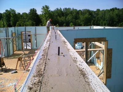

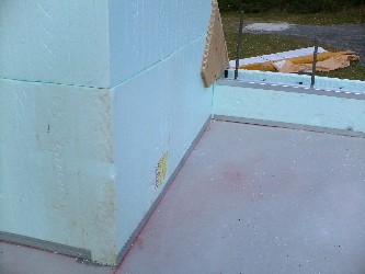

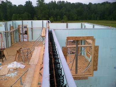

I have been using steel track for 5 years now. I have tried all of the before mentioned ideas. Personally I will continue using track since I have been getting the best results. Someone mentioned that it gets the wall to lean if you only track one side. That is all I do. I will use the outside if on top of a footing and on the inside if on top of a slab (that way the wall is perfectly straight for the trim, nothing worse than looking down a finished wall and seeing wavy trim because the foam didn't hold). Once you plum the walls with the bracing there will be no more leaning.
I no longer have to worry about whether the foam will hold due to the cold or wet conditions, working in Ontario you constantly have that problem. In the past we have used the foam and would hear it pulling away from the footings when we adjusted the bracing. Another person said they only use track in sections because they have to shim the block to get it level. As long as you do your own footings this should not be a problem. Buy a laser level, take extra care when setting the tops of the boards, use more stakes than normal, keep the laser going during the pour and keep checking the wet concrete. It is much easier and less time consuming to trowel out wet concrete to get the footings level than to adjust the blocks by cutting and shimming. Once I start laying block I know that I don't need to check the top of second course because the footings are bang on, (although I will still eye down the tops just to make sure).
After visiting Chris in California and watching how he needs to set the anchor bolts at the top of the wall before the pour by attaching them to 1x2 and then screwing that to the track set on the top of the wall, I have now adapted that process to my work as well, and must admit that I have never got my walls so straight, the track also makes a nice smooth surface to trowel off to as well. Some of my customers who have viewed other jobs have commented on how neat my walls look. And thats how I keep busy. Now I know that others will say..."we don't do that, thats a waste of time and money, we do it this way or we do it that way" which is fine, every one has their own ideas. I just wanted to correct those people who misinform others by saying things like 'track makes the walls lean' which is not true, inexperience makes the walls lean, trying to rush a job makes the walls lean.

You like that top track EH!!!
Are you wet setting AB's?

Yes, EH! I do like it, I like it a lot!!! Yes Chris, up here in Canada, we are still allowed to wet set AB's, I am sure you haven't forgotten, have you? But that is not me doing it in the picture, it's the Homeowner.
Paul Stevens
