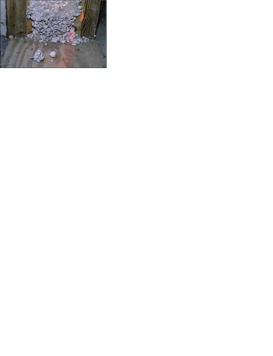

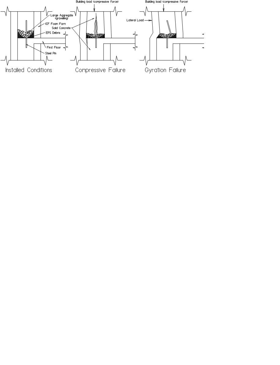

The concerns may or may not include the following, however this is typical if it is not a garbage problem at the bottom of the wall and occurs quite frequently with 5" plus slumps and concrete additives such as fly ash or plasticizer.  This is a good example of graveling and if you can slide a saw blade under the form, the failures will occur later.  Let alone the rusting problem and steel failure.

18 Mar 2009 11:39 PM
and here i was thinking gyration factor had something to do with me on the dance floor.
phew, thanks Mark.
