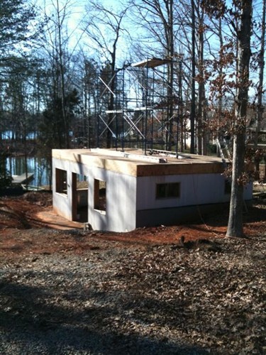

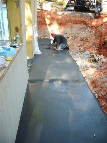

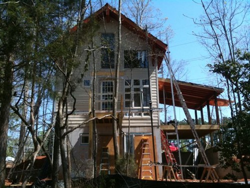

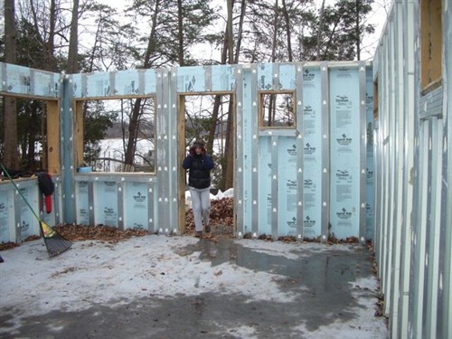

I paid close to $10,000 for 96 feet of 10 ft walls insulated to r12 installed in 2008. I excavated and placed the stone myself, useing alot more stone than called for. It was cheaper to have The Sealing Agents do the waterproofing than to do it myself. Im gonna try to include some photos. One shows the curb i placed on the outside of the wall where it was not backfilled. The wall has tabs on the on the inside that had rebar placed in it before the slab was poured around it but as an added precaution i poured a small slab outside of the wall for added measure. If a tornado comes we will be in the basement fo sho! I would enjoy answering any questions about any part of the project. javascript:amaf_insertHTML('%3Cimg%20src=/DesktopModules/ActiveForums/viewer.aspx?portalid=0&moduleid=369&attachid=3492%20border=0%20/%3E');amaf_toggleInline(3492,7093,0);javascript:amaf_insertHTML('%3Cimg%20src=/DesktopModules/ActiveForums/viewer.aspx?portalid=0&moduleid=369&attachid=3493%20border=0%20/%3E');amaf_toggleInline(3493,7093,0);javascript:amaf_insertHTML('%3Cimg%20src=/DesktopModules/ActiveForums/viewer.aspx?portalid=0&moduleid=369&attachid=3494%20border=0%20/%3E');amaf_toggleInline(3494,7093,0);
Attachment: superior_wall_curb.jpg
Attachment: superior_walls_interior.jpg
Attachment: lake_house_before_day_before_we_started_the_si.jpg
Attachment: view_from_the_dock..jpg
