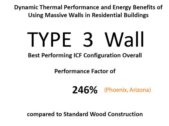

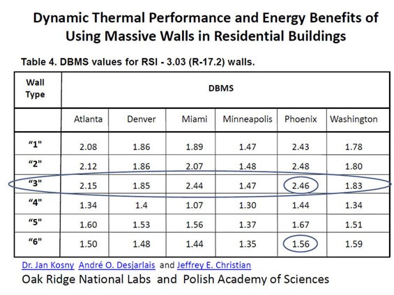

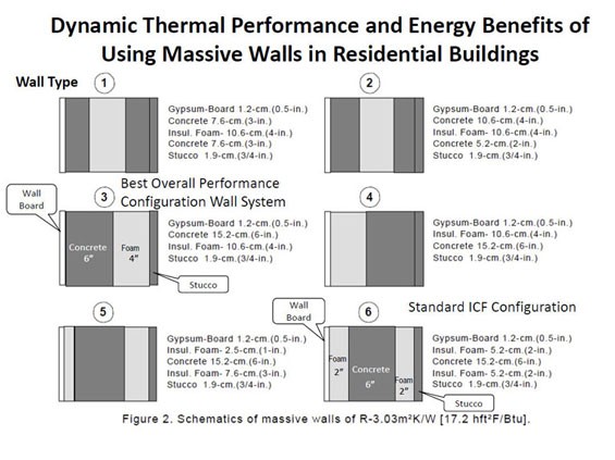

I spent this past Saturday morning with Don from Isomax-Phx. Don is very knowledgeable and has a real passion for all-things-green. He's developed a wall configuration made of hardi board/6" concrete/4" foam (from interior to exterior). This has the advantage of exposing the mass to the interior while super-insulating the exterior.
The Oak Ridge National Laboratory just released a study where this particular configuration provided the greatest energy benefit in my area. In Phoenix it proved to have 246% greater dynamic thermal performance than wood-frame. That's quite a bit better than the already good performance of a standard ICF configuration at 156%. I'm taking a close look at this in making my choice of wall types.
You can find the ORNL study by doing a web search for "Dynamic Thermal Performance and Energy Benefits of Using Massive Walls in Residential Buildings" .

Here's a summary of the study findings.

Thank-you for the above post. Standard drywall is of course replaced with either Hardie, MgO2, Viroc or any other cement board that has the characteristics of not rotting, fireproof, minimal water absorbtion as well as deformation. Adding 20mm PEX tubing (as is described in Heated - ICF wall - in your case " Cool ICF Wall" - full pun intended) the performance will be "off the charts".
