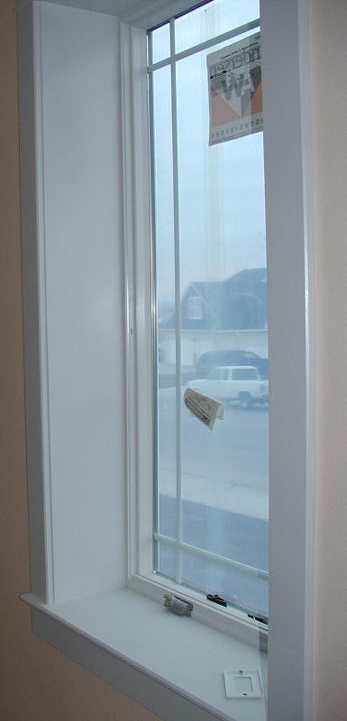

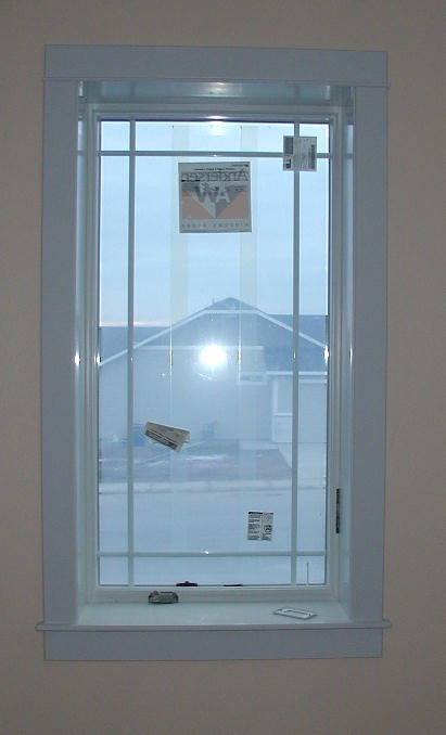

Maybe these two pics will give you an idea of what a thick wall window would look like in your case. This is in my house, (coming close to completion, whew!!). The walls are 6" ICF, 11" total form thickness, about 12 1/2" total thickness counting drywall and Hardiplank siding. The windows are flange mounted to the outside of the ICF. The window glass surface is about 10" to 11" behind the wall surface. These are bedroom windows. The larger is 62" W x 60" H, the smaller 32" W x 60" H. I don't get any sense whatever of "tunnel" view even with the smaller window. One dining room and two living room windows are 6' x 6'. The deep jamb extension makes them look better, I think. The wide sill is very inviting to sit on or set plants, etc. on! I can post a pic of them after we unmask them after painting, if you want.
Attachment: Bdrm large window.jpg
Attachment: Bdrm small window.jpg

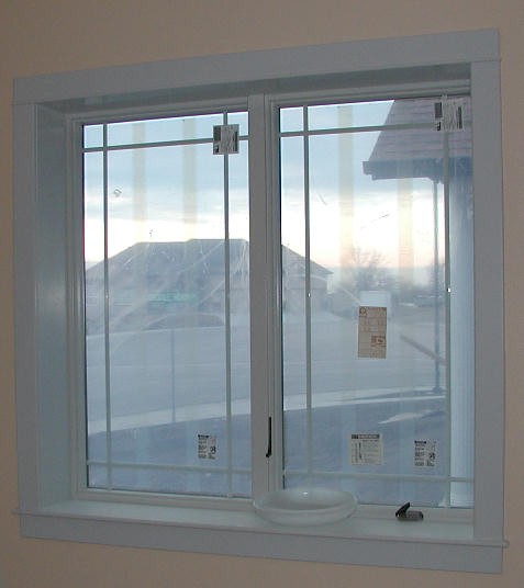

Here's a straight on shot of the smaller window.
Attachment: Bdrm small window straight on.jpg

These are great photos and are representative of what to expect in any ICF home. The addition of brick will not substantially change the appearance.
