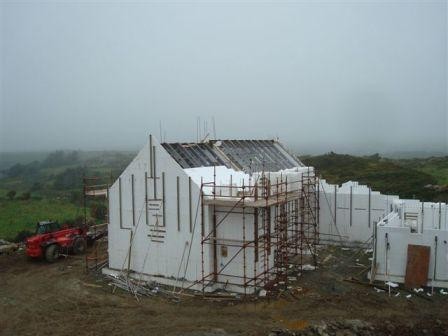

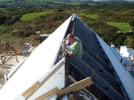

This is the best way we have found to do a true ICF roof, without shoring.
Attachment: Interga Roof2.jpg
Attachment: Interga Roof.jpg

Thanks for all the input, including yours, Manfred. I will tell you that I have made the same suggestion to the Mrs. before but she has concerns about the poly sprayfoam (out-gassing, etc.). I don't know. It may still come to that, using some type of engineered wood or metal rafter trusses. Initially the idea was to use the best, strongest building components that would compliment the ICF walls AND provide maximum protection from Mother Nature, but now it seems we've decided we need to be concerned with a super-insulated roof to hold in as much energy as possible. Mark, I've seen you post these photos on the other thread and it looks good, but could that be poured into a 3/12 pitch?

yes it can, however requires a very specific concrete mix.

Nice house Ross; roof looks great!

Mark,
This is a great example that concrete construction is only limited by your imagination.
