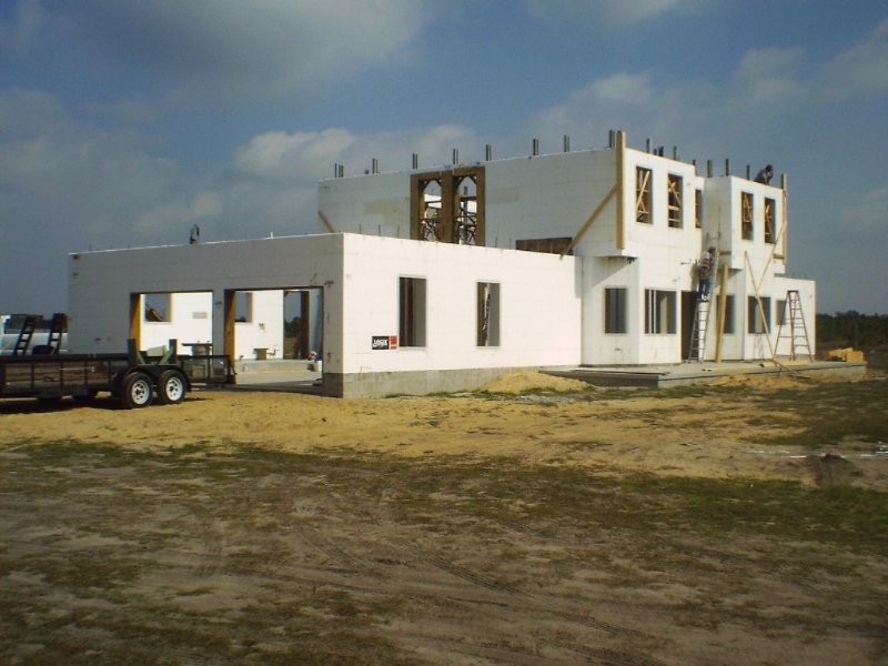

The cmu wall here in central fl will be $6-8 per sq ft with rebar and lintels poured. Now add furring and insulation to the interior of the wall.
The cmu wall as typically done here in FL will be about R-13 This is very inferior to ICF
We typically use 6"core ICF which far superior to a typical block wall
I have found that typically a cmu house that requires 5tons of AC, the same house in ICF will be a max of 4ton.  This reduces the cost of installation by typically a min of $1400 now add this to the cost difference of cmu and ICF, along with the reduced energy bill.
If you are going to use hardie bd you will typically fur the ext of a cmu wall,  No need to on ICF which again affects the cost dif.
Don't frame your second floor!  Do it ICF
You can't simply compare the cost of cmu installation and ICF installation, there are many factors due to the individual home.
Attachment: misc2 001resize.jpg
