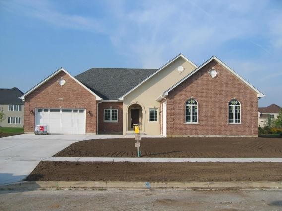

As an owner/builder, I'm in the final stages of building my ICF house.  I thought some members of this forum will be interested in what it cost me to build with ICF.  If so, read on.
It's a single story house of 2200 sq. ft. and a full basement.  The plan is moderately complex with 14 corners and 4 T intersections.  I used TF System vertical ICF forms - 8" for the foundations and 6" for the above ground walls.  The gross wall area is 5300 sq. ft. with moderate window and door area framed with pressure treated lumber.

The labor cost of $20K is a quote for the job.  Actually, my son and I erected the forms ourselves with the help of an experienced ICF installer and saved $15,700 in labor costs.  That reduced my out-of-pocket cost to $7.20/sf.

No, the gables and roof are stick built, and so are the garages which have conventional poured concrete frost walls.  Those decisions were driven by my overall project budget.

Beautiful house! How do you like it so far? Welcome to the ICF homeowner club. :)

Real nice place. Never have I seen a double garage but separated like you did. Almost didn't even notice the one to the right, good idea. That way the garage doesn't look bigger than the house!

Thanks.  Also, the garage door is 10' high to accomodate my 22' Class B motorhome.  Every other design made the garage door stand out and spoil the appearance of the house.

Nice house, Clark!

nice curb appeal
