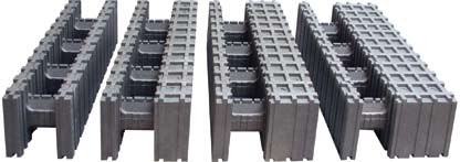

Just to clear Isorast2000.com has no rigts on ISORAST as stated on their website, nor that that they are allowed to sell licencies. If somebody wants more informations write to [email protected] We have arranged everything to produce in the USA but it needs orders to start production, and any order could go out of Germany within 24 hours. Of course we are a bit higher in pricing but look at the product and compare. any competitor in the USA will have higher pricing if they use that thickness or quality.
Attachment: neopor blocs.jpg
