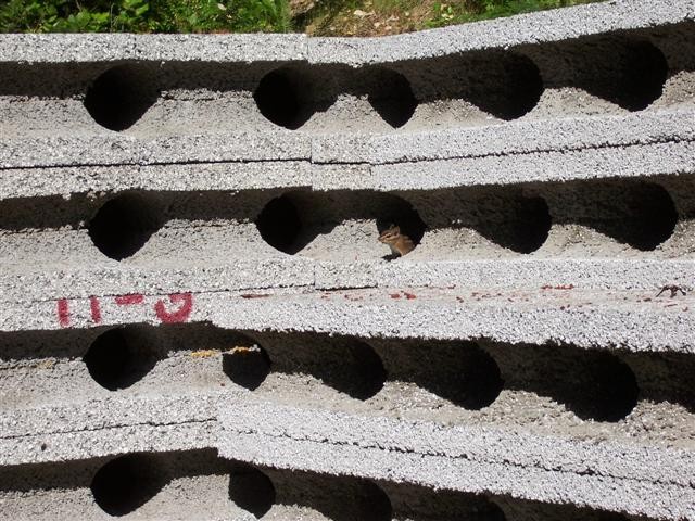

I built with an ICF listed under the IRC as a "screen grid."  Because it's a grid, it basically has " 6 inch holes" alligned vertically and horizontally 15 inches on center.  In theory, a condition much worse than plastic ties arranged in a similar fashion.  Yet, under destructive testing, the screen grid walls test out remarkably close to solid ICF construction, even under lateral loads (i.e., seismic situations).  Cracks, plastic ties, and even holes, just don't have as much effect as you might think.

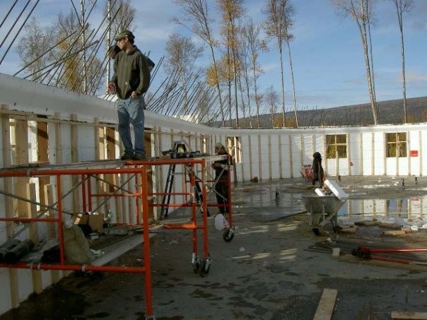

That doesn't seem like a lot of steel to me.  We just poured our walls a couple of weeks ago, I have #5 grade 60 vertical at 8 inches OC and 16 inces oc horizontal....and 4 runs of #7 horizontal on the top.  heh
