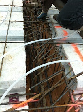

Do you have a pic of that beam? Was the beam a glu-lam beam?
ICFHybridUser is Offline
Posts:2125
01 Sep 2012 09:15 AM
In this case, describing it might be as good as a picture. It's rectangular in cross section, about 24" high and 15" across and it looks sorta grey because it's made out of concrete. You can't see the steel reinforcing bar that is cast inside.

I got you some pictures.  The first one is of the beam attach point and the second one is looking down into the beam before it is poured.

02 Sep 2012 12:31 AM
How does that beam affect being able to use the tubes in the isuldeck/quaddeck? It would seem to me, based on your photo, that it'd basically remove them from the equation....
Posts:2125
02 Sep 2012 01:18 AM
Looks like the tubes go right over the beam with no problem.
There was a bearing wall on top of a portion of the beam so we only needed to cross over at a few places like halls and doorways.
lowcrawlerUser is Offline
Posts:7
02 Sep 2012 01:20 AM
But if you fill the entire area with concrete, those tubs would fill in as well... no?
