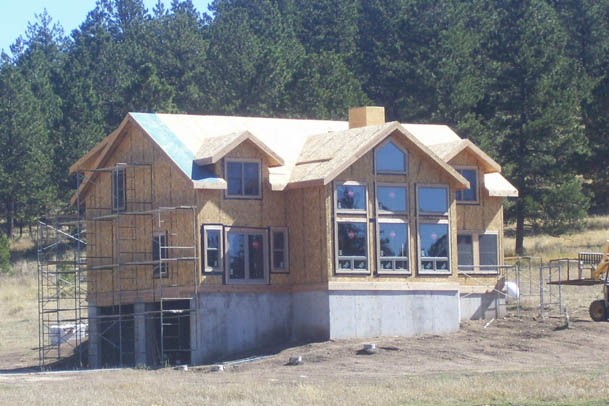

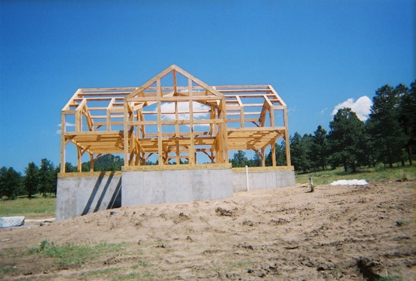

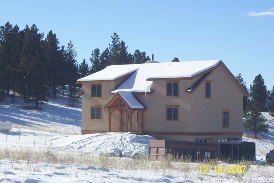

(1st one is the finished frame, raised in TWO DAYS)
(2nd one is the finished SIPS)
(3rd is the finished stucco).
Anyone want to see the interior?
Attachment: SIPWEB1_997939-R1-06-5A.jpg
Attachment: SIPWEB2_PB&T Exterior Back.jpg
Attachment: SIPWEB#3_PB&T_Exterior_Front_Snow.jpg

That timber framing looks amazing. Bring on the interior pics! :)

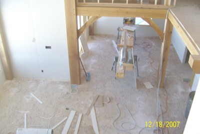

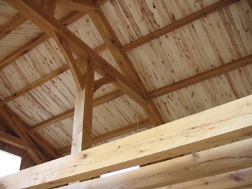

Pictures of the interior.  The ceiling is Aspen and the frame is all white oak with hickory pegs.  Drywall is going up.
Attachment: SIPWEB#5_PB&T_GreatRoom_Drywall2.jpg
Attachment: SIPWEB#4_Celing2_small2.jpg
