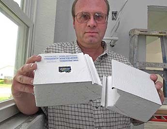

Seems like steel skinned SIPs are making more sense with no thermal transfer thru splines or studs?
Attachment: homes-foam.jpg

That is a 'spline' issue. Many OSB SIPS offer a connection method(spline) that is not thermally conductive.
