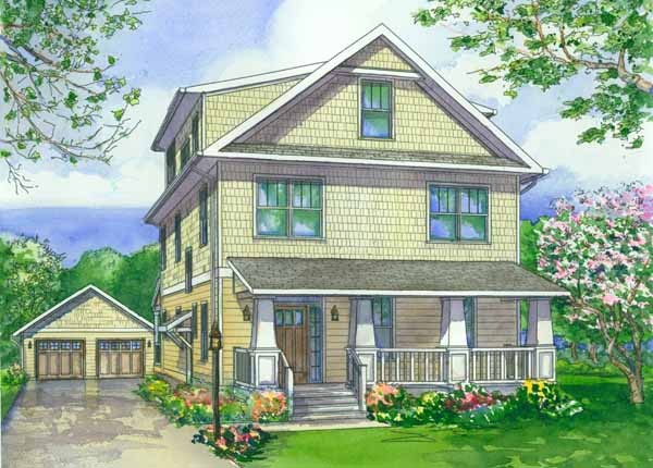

blackdogarchUser is Offline
16 May 2008 03:36 PM
Yes. That was my point in the first place. Think of all the older homes in smaller neighborhoods with a large dormer for the 2nd floor. Now do it nicer. Come in about 16" or so from the gable ends and build a knee wall on the main roof (or from the floor if you want to close it in inside) (or directly up from the gable walls if you use a deep overhang on the gable ends)and raise the side wall up to whatever gives you the 4 pitch. Or decide on a desired window head and get the dormer pitch that way. Remember roof shingles need a minimum 3 pitch (check with manufacturers about your area). We often use Ice and Wtaershile over the whole dormer, but I recently heard Foard Panels express some misgivings about that, so check with your supplier. At a minimum use 2 layers of 30# felt. It is more breathable than the Ice and Water shield.

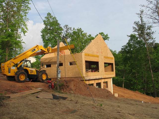

16 May 2008 03:38 PM
Fly840;
are those headers over the large gable end openings ?

ReadyToRetireUser is Offline
Posts:212
16 May 2008 03:54 PM
I am NOT experienced with SIPs and have little construction experience, so this is merely a question, *not* an assertion:
If I am reading the picture right, it looks like one side of the beam pocket is at the joint between two panels (it looks like there is a vertical shadowline there).  If so, is that common practice?
Larry
16 May 2008 04:00 PM
You need a post below a beam, so it will be set between the panels.

fly840User is Offline
Posts:43
16 May 2008 06:48 PM
Those are headers, beefy ones at that, and will now be used as headers for doors, as opposed to windows. These pics are current as of two weeks ago, I now have a deck outside those two openings. I love the pics of the shed dormers and that is a great idea. I am probably past that at this point. I was hoping to use the existing dormer material to maybe make some kind of dormer in the 4/12 roof. Not so sure that would be so easy. I am definitely an amateur and will learn much from my many mistakes for the next one.......righhhhhhhhhht, there will be no next one:)

Posts:1649
16 May 2008 06:56 PM
Bill;
Normally no header is required for a non- load bering wall especially with SIP construction? Why the overkill?
info@southernsips.com
