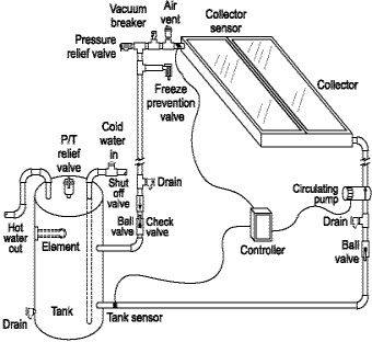

P
It is expensive and a little complicated to set up at first because of the need for heat exchangers, pu and learning.
It really is not that expensive to make adn set up.  If I atttached a copy of the system diagram successfuly you wil see that anyone with enough guts to build their own house can handle this pretty well.  You can build your own solar panel getting most of the stuff needed from your  local house builders dumpster.  I can e-mail directions for construction of a solar collecter is anyone wants.
Attachment: HWdiagram.gif
Attachment: Hotwater system.gif
rnortmanUser is Offline
Posts:93
01 Aug 2008 07:44 PM
That setup in the diagram doesn't include a heat exchanger.  This means that your drinking water flows through the solar hot water heater.  I have never set one up myself, but I've seen the setups, and my understanding is that it's a good idea to put antifreeze (I think just glycerin) in the water that goes up to the roof, at least in a cold climate.  This is a closed-loop type of system, where the water just recirculates continuously.  You get the heat out with a water-to-water heat exchanger, as I mentioned above.  But even with that extra complexity, it's not so bad that you need an engineering degree to make it work.  Add in hydronic heating and things get a little more complicated, if you want to use the solar hot water for heating up both the floor heat water and also the domestic hot water.
